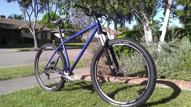

  5. #905
    Mar 2013
    10
    This is Honzo #2!
    I liked the orignal one so much I had to have one that was singlespeed!
    Attached Thumbnails Attached Thumbnails Honzo Build Thread - post your builds here-2013-06-02092245.resize.jpg

    Cool-blue Rhythm Finally, she is finished!
    Took me a while...(edit: added better pictures)
    It's amazing how different this bike is to the 2005 Trek 6500 I just sold, so playful! I already had to jump off twice when trying to do wheelies while I couldn't even lift the front wheel of my old Trek.
    • XL Frame
    • Rockshox Revelation 140mm (Anyone know what the LS, COMP, +, - dial does?? Can't find a manual anywhere)
    • Chromag Fubar OSX, Renthal Kevlar grips
    • Thomson Elite X4 Stem 50mm, Hope spacers and Head Doctor
    • Thomson Elite stem, Fizik Gobi saddle and Hope seatpost clamp
    • XX1 crank w/ 32t Wolftooth spiderless ring
    • DMR Vault pedals
    • Surly 18t rear cog + Surly spacer kit (their manual is awesome for getting the perfect chainline, just measure the chainline and look up the number and order of spacers in their chart)
    • DT Swiss 240s hubs
    • ZTR Flox EX rims
    • Shimano Zee brakes, Icetec rotor 180/203
    • MK King 2.2 rear, 2.4 front
    I still have to buy a shock pomp, as you can (barely) see it already almost bottomed out. (Edit: taken care of).
    The rear disc is still rubbing the brake pads, I'm fairly certain the rotor is not entirely straight, I can see it wobble a bit at the same moment I hear the rub when I spin it. Not sure what I'm going to do about it, it's very minor.
    Edit: meanwhile I also corrected my chain tension, stretched a bit after my first few rides.
    Honzo Build Thread - post your builds here-p1010687.jpgHonzo Build Thread - post your builds here-p1010689.jpg

    275
    My Honzo
    Here's my Honzo. No idea if the image above's going to work!
    Long story short. Had a Fisher Superfly and broke it. No warranty coverage from Trek as it was a 2008 model (crashed hard in 2012 and put a hole in the seat stay) and needed a frame fast. Of all the non-custom frame sets in the world, I know I needed something with a long top tube as I am 6 foot 6. Aside from an XXL Specialized Stumpy Al frame, the Honzo was the only other choice.
    The choice was easy.
    I freakin' love this frame. Took me about a year of ebay shenanigans to get at the parts where they are. I'll run through them with some thoughts and questions below that. I'm hoping this post is informative to others looking to take the leap and go with a Honzo.
    Frame
    2012 Kona Honzo, 22L (26" ETT Baby)
    Fork
    2012 Revelation RL @ 140mm
    Headset
    Cane Creek 40
    Wheelset
    XT Hubs, WTB i23 rims setup tubeless
    Tires
    WTB Wierwolf rear, Bronson front
    Drivetrain
    Zee rear der. and shifter, 11-36 SLX hub, XTR chain (don't ask me why) Wolf Tooth Components 32t Wide/Narrow Ring, Bontrager Race Lite Carbon crankset (leftover from Superfly)
    Brakes
    Shimano SLX front, Avid Juicy ultimate rear (leftover from Superfly)
    Seatpost
    Reverb 125
    Saddle
    WTB Somethin Somethin
    Stem
    Thomson X4 80mm x 0 (in photo. recently replaced.)
    Handlebars
    Answer 720 AM - 52mm Rise
    Grips
    ODI Ruffian
    Pedals
    Crank Bros Candy 2
    Putting the recommended amount of air in both chambers of the Revelation yields too harsh of a ride and only 60% of travel used after a hard ride. I'm now at between 20 and 30 PSI LOWER than recommended and everything is great. I like the fork, but will upgrade to a Pike sometime in the next 3 years before my bike funds become baby funds.
    WTB's Wierwolf is labeled at 2.5 but in reality is 2.1... it's actually narrower overall than a Bronson if you include knobs. FYI.
    I had wanted to run a short (70mm) stem on this but at my height it just ain't happening. Shown is an 80mm x 0 but after getting the sag right on my fork I found that a 90mm x 10 was more comfortable. I can always drop it down using headset spacers if need be.
    Droppers posts are awesome. I use mine whenever things get fast and or steep. The ability to get low over the bike when you're descending is amazing.
    Wide narrow rings are the future. Get one. No dropped chains with this setup, and will be switching to a 30t for a trip out west in September.
    Overall I find the Honzo a blast to ride. It's forgiving, which is good for long rides, but can be moved around easily and really shines in technical terrain. Very very easy to pop the front wheel up. It's a bike I feel like I can really grow into. I will never ride a bike intended for XC racing when I don't race. And it fits me, hallelujah!
    I also have never received more questions about a bike than I have with my Honzo. Last time I was up in East Burke, VT it got so much attention it became a running joke between my dad and I (pop's rockin the Tallboy.) People either know that its a Kona but are unaware of the model, or have no clue what they are looking at. It never gets old.
    Any questions fire away!

    @hjulier: You now have forced me to go place an order this weekend at the bike store way across the valley!!!
    I stumbled on this model last weekend and immediately was drawn to this mountain bike. I have a niner RIP9 and it's a great FS bike but I miss having a hardtail and I have been influenced to get a steel frame. I was stuck on the Niner ROS9 for a bit but this Kona bike just ROCKS! It may not be the best bike out there but the components and the build for the price is why I'm sold and I don't want to fork out $$$ for another Niner. I'm a big boy (6'1", 270) so I predict this bike will handle my weight (at least I hope!). OK enough of that rubbish
    Looking at your set-up is creating all kinds of thoughts in my head so I will start with a few questions:
    * Any disadvantage having the 140mm fork on this frame and geometry? I was curious if they designed this specific to the 120mm only. I'm not sure if you had a 120mm (thinking you did not buy the complete bike and purchased the frame only)?
    * What are your thoughts so far with the WTB i23 rims setup tubeless?
    * How is the Shimano SLX brakes handling for you? I have the XT's on my RIP and those are such solid brakes but if the SLX handle then no need to change out
    *I've been "anti" seat post dropper but I realize the value if you quickly convert from an aggressive downhill to normal conditions so not having to worry about having to get off the bike and make adjustments has a peak interest for me. I assume you are very pleased with Reverb 125. Considering my height is 6'1" I wonder if I can sneak by with the 100mm version since it's on sale. Any thoughts on that consideration?
  93. #993
    275
    Will reply to individual questions below in green!
    Quote Originally Posted by 29er Kid View Post
    No disadvantage. I think most people would say (unless you are super short and want the front end lower, which you're not) that this bikes is made better with the the fork set to 140.
    They're great rims and good for your big boi status. The stock Honzo comes with a similar spec width wise. Running WTB tires on the I have had absolutely no problems setting these up tubeless and they lose air at an acceptable rate (the same as a tire and tube would)
    SLX brakes are God's gift to man. Rock them.
    You can get away with the 100... I almost wish I had gotten the 100mm in the shorter length... save some weight. I found my reverb online and got a good deal. I mount my "right hand" lever upside down on the lefthand side. I have not regretted the purchase, but if I were you, I'd save and wait to get a Thomson.
