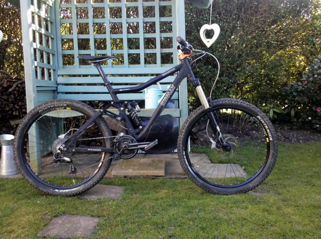

    Ghostt
    Here's a more up to date pic:
    Awaiting a Reverb and Ti spring for the Van RC
