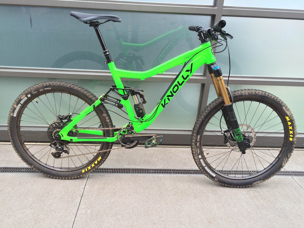

    Great builds in here.Chilcotin. .. best trail bike ever. I just put a fox 180 VAN on mine after punching a hole in my old 36 lowers. I love the higher bb height. That combined with ccdb coil out back, = phenomenal techy climbing.

    quick fit question for you guys. im in the 5'10 medium / large inbetweener club. 31" inseam slightly longer torso went with the large. got a 35mm stem, 20 mm rise on the bar, 20mm of spacers, and the fork set to 170. feels pretty good for everything in attack position even though it's a tad long in reach.
    hit some real steeps for the first time and had a super hard time keeping my weight off the front end. when i tried to hang off the back i got so stretched i could only really straight line. thinking about bumping up the rise on the bar and / or pushing the fox 36 to 180 to compensate.
    what do you guys think?
    only issue i've run into so far. otherwise an incredible bike! the ccdba / 36 / 4x linkage combo is soooo plush. rips corners, floats over chunky stuff, and climbs extremely well. puts power down like a beast with the climb switch too. love it!
  37. #1337
    Reputation: mayha's Avatar

    Quote Originally Posted by niccolope View Post
    The bike looks incredible! And nice job with the stealth routing. It's strange that you feel too much over the front end while feeling too stretched. Seems like an opposition....If you attack low and centered you should feel invincible on this rig with your set up.
    Good luck! The bikes' a ripper

    oh sorry if it was unclear. basically to get low enough to feel centered for the steeps i was hitting the saddle so i tried hanging off the back. (edit: on mediums i'm behind the saddle by default) but when i did it made the long reach reallllly long since i'm shifting my body further away from the bars.
    other two things i thought to try.. some extra air in the fork for a higher ride height and completely slamming the seatpost.
    it's a beaut for sure! woo
    I'm running a 150mm dropper and have a little less post showing - and if it is getting really steep, I find slamming the dropper the extra 1" allows that extra bit of confidence.
    And yes, not having too much squish up front is a game changer on the steeps. I recently swapped from an undersprung air to a slightly oversprung coil and it is much better.
    Agreed with mayha though, get centered and off the brakes and you'll be invincible.

    Yeagh. Agree with these dudes. It might also be that you have too LITTLE sag in the shock...so it is the balance between the front / back of the bike you should try find...it might also be the rebound on the rear is too fast...giving you a feeling that you are being pitched forward (and therefore hanging off the back).
    Focus on getting the bike balanced (front / back) - get the sag right on both and try match the compression / rebound and then tweak them to preference.
    Your Low Speed Compression will affect how the fork reacts on steep sections...e.g. if I am riding a slow / tech / steep trail I will increase the LSC to get the fork to be a little firmer / stay a little higher.
    I think 170 is plenty fork and 180 will be too much.
    Have fun - let us know how it goes.
    Have fun m

    Awesome! Thanks for all the great advice. Gonna slam the dropper and adjust the suspension before tinkering with anything else.
    I think muttons is right about the problem stemming from a combination of shock and fork settings. There was clearly a lack of air and LSC in the fork for the steeps. The brake dive was pretty bad. My fault had just fiddled with that before the ride. But I also like the idea of more rebound damping in the rear. I know the CCDBA is still a ways off from being dialed. Had one before and know how good it feels when it's perfect.
    Been sick the past week so I've been dwelling on it without getting to test. Should be riding again soon. I'll let you guys know how it goes!

    Got another ride in on the same trail and had a much, much better time.
    Ended up completely slamming the seatpost, resetting the fork to the factory tune (+10psi, +4-5 clicks LSC, -2 rebound), softening up the CCDBA (-1 LSC, -2 LSR), and putting an extra 5 mm spacer under the bars.
    The suspension tweaks made a huge difference. The fork stayed up in the travel a lot better on the steeps and the DB was glued to the ground. Combined with the saddle slammed and out of the way I was able to manipulate my position and the bike like I normally would. No issue with brake dive either even though I was going way faster and using them in strong bursts compared to dragging when I was feeling uncomfortable. The extra spacer under the bars wasn't really needed with the suspension changed.
    Ended up getting pretty loose on a few sections with all the extra confidence haha. The Chili rolled out of all of it and kept me upright on a few sketchy drifts Not surprisingly the bike did everything better with the adjustments. Bunny hopping felt more balanced, weighting the outside pedal to rail turns and berms was easier, pumping more controlled, the rock crawler climbing traction.. basically doing everything the Chili should be doing.
    Still needs more tweaks but I'm super stoked. Was worried for a minute the frame was just too big. Woo! Thanks for the help
