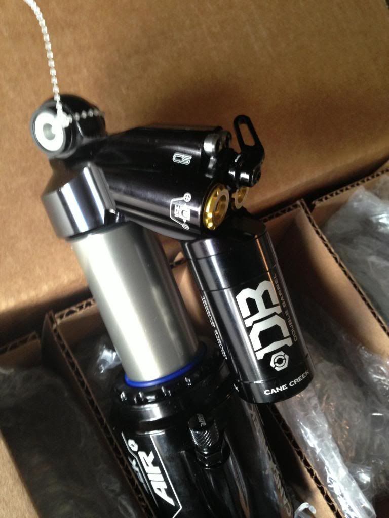

    First shipment of Cane Creek DBA-CS has arrived!
    These are ready to ship on all Endorphin and Chilcotin orders. Get 'em while you can.
    These units come with frame purchases only, no one-off sales. Sorry!

    I was confused by the tune for the longest time. I chatted with bike shop, bike shop chatted with Cane Creek, I argued with bike shop about misinformation based on internet descriptions, eventually called Cane Creek, Cane Creek representative wasn't 100% sure, placed me on hold multiple times to answer my questions. I lost confidence in what was true. I contacted the one person who knows everything bike related - Noel Buckley - got real answers.
    I'm paraphrasing my understanding and conversation with Noel.
    The CS tune is an extra circuit that runs in addition to the external tune, when turned on. However, this addition is not linear and is based on the external tune. Companies (like Knolly) test the DB AIR CS with first their external tune and then tinker with the CS tune. These are determined together. Knolly has provided base tunes for the Endorphin, Chilcotin, and Podium to Cane Creek. All your dealer has to do is say which bike model. I am getting one for my Delirium which Cane Creek did not have, so I need to understand this to get the correct shock tune. Noel being the guy behind the Knolly suspension was able to provide a very good guestimate for the Delirium, even though they didn't test for it.
    In the end, if you are buying a Knolly DB AIR CS shock for any of their primary models - Endorphin, Chilcotiin, and Podium - they have those settings on file, so no need to worry.
    If you bike isn't in their system, they have an OEM tune setting, which supposedly is median of their test bikes.
    In setting the normal DB AIr, we find an ideal setting for climbing and descending and stick with it. However, it is a bit of a compromise. With the CS, we get the best of both worlds plusher for descending and firmer for climbing. As I have learned with the LSC lever and now the LSR lever, the range of 5-6 clicks though subtle makes a big difference in ride behavior. Noel pointed this out to me.
    I am excited about the shock, because I will get a bit better pedaler without being a true lock-out maintaining Knolly's active suspension and traction and then get a bit plusher ride on the downhill. What is not to like, well except the price, but performance comes with a price.

    The little lever only allows for ~ 5 clicks. I have it dialed so that in the middle setting is it my standard position and then depending on the climb or descents I add or substract clicks.
    Quote Originally Posted by thedeathstar View Post
    I'm not sure I understood exactly what you mean when you say that the cs is based on the external tune. Is it that wherever you have your lsc and lsr set, it adds a specified amount of clicks to each that you can possibly decide?
    The external tune - it what we can adjust. However, each bike suspension has a particular external tune (see the Cane Creek website). The CS is not a direct number of clicks. It is adjustment of the valves, guts, etc. Knolly and others will first set the external setting and then base the CS tune relative to the external setting. From my understanding, if you deviate a lot from the external Knolly tune, then the CS tune may not be as good, but I don't think it will be bad. This because the CS is an additional circuit, so you will also get some more LSC and LSR.
