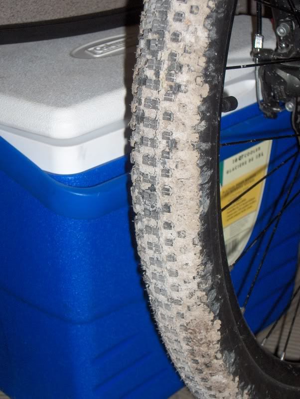

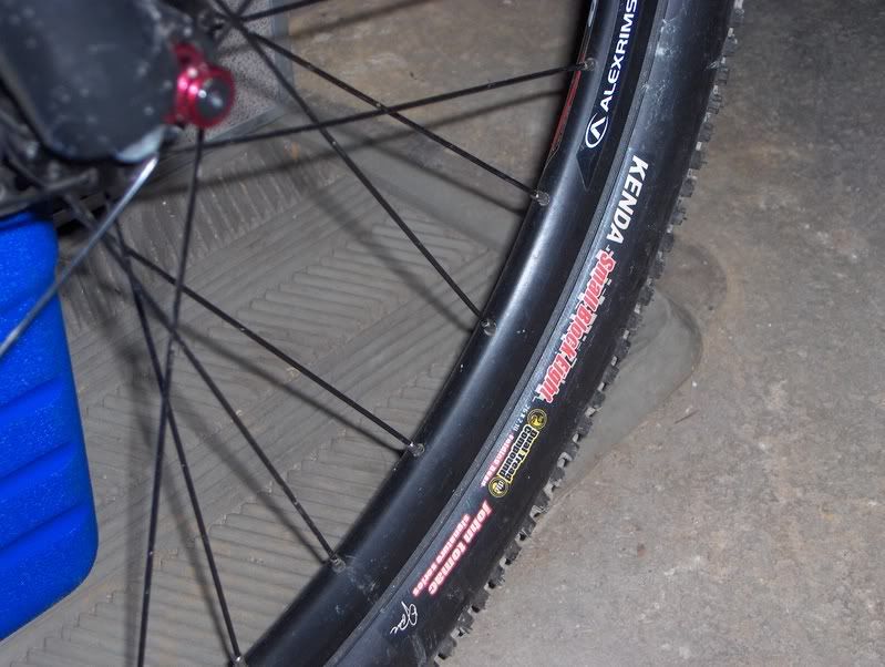

    Not long after I bought it, I realized just how much riding knobbies on the road sucked. After some research, and some great advice from you guys, I picked up a set of Kenda Small Block 8's, in 2.1. Gotta admit, I love em, on, and OFF road. As you can see, I took them offroading this past weekend, and they held their ground quite well in the muddy conditions.

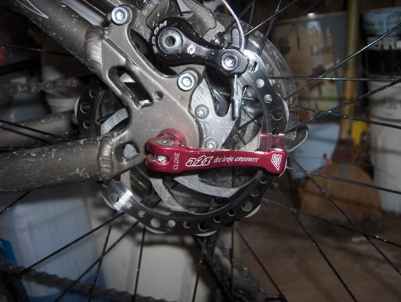

    A couple weeks ago, I also added some new A2Z Skewers;
    Front.
    And rear. They work and look great, without costing the arm and leg that Salsa's do up here.

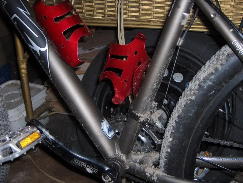

    Around the same time, I also added some Cat Cage bottle cages. I do own a Camelbak, but sometimes, especially when it's really hot, I'd rather not have to bring my pack, so I use bottles.
    They work great for me. You can mount them on their sides, for easier access on smaller frames.

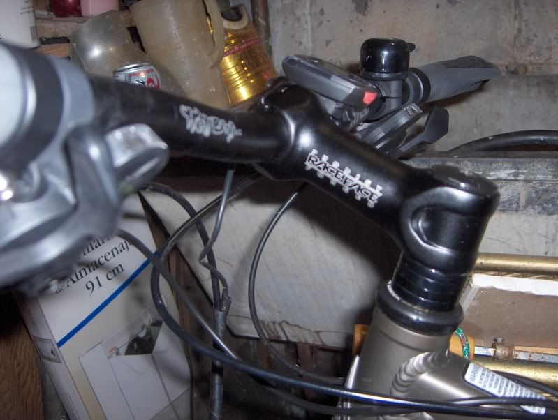

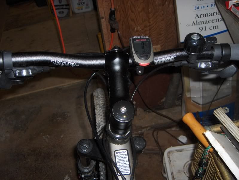

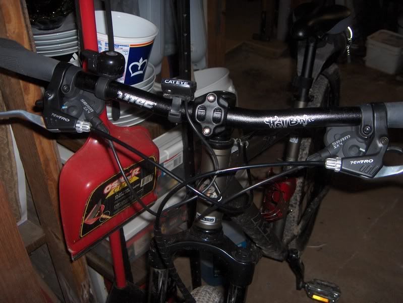

    Now today, I met up with someone from Craigslist. I picked up a used Titec Hellbent XC riser bar, along with a Race Face Prodigy stem to match for $30. Seemed to me like a great deal that I just couldn't pass up. Here they are installed. Just need some dryer weather to get the bar adjusted to where I like them. You can also see my Ergon GX1 grips I bought a while ago. I absolutely love them. No more numb hands!

    before you unload the brakes, try playing with the adjustments. Those levers default position is a long ass way from the bar, the black screw above the K in tektro will move them inward, and keeping the pads close to the rotor will feel a lot better. Avid makes a kit with steel tubes for the cable to go through that really helps cable disks a lot as well. Runs like 40$ and can be transferred to a bb7s if you wish.
