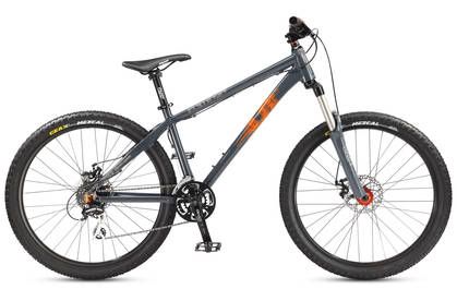

Hey guys, bit late to the party but saw this frame up on facebook for sale a week or two ago and had to have it! been browsing everything here, some mint bikes.
Anyway, here's my offering. an '08 komodo. Plan is to build it up with my old 36 VAN forks, just waiting on headset and working out what travel I want (suggestions appreciated :) ).
For now it's my DJ and park bike, and I can see why everyone loves these!
Tire Wheel Bicycle tire Bicycle wheel rim Bicycle wheel
#452 ·
Well, if you're tall then that bike will have to be a DJ or Street bike. It looks pretty small. That said 80-100mm fork would be about right.
If you're short and it would fit you to pedal it a while, mines set up at 150mm as a trail bike. I've had it anywhere from 120-160mm to rigid. It works well everywhere but really shines at 150.
Mine is the 2005 on the previous page.
