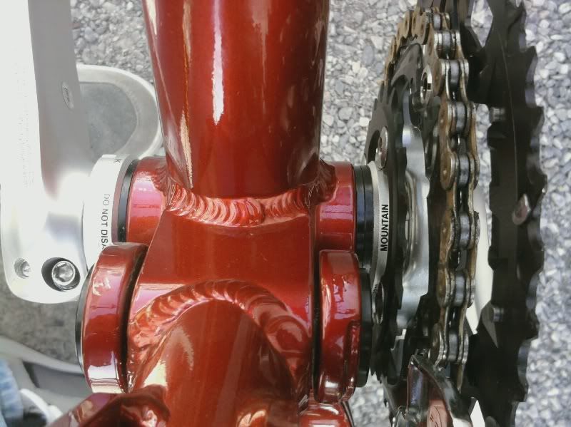

    I pulled the crankset and bottom bracket out and weighed them today. I can't edit my old post so I'll just update the information here:
    Frame:
    With Fox Float R Shock (17") -
    Forks:
    Marzocchi 44 ATA TST2 w/15mm skewer (195mm steer tube) - 2176g
    Wheels:
    Mavic XM117 w/Formula Hub 15mm w/Avid rotor, no skewer (front) - 1001g, 879g no rotor
    Mavic XM 117 w/Shimano M475 Hub w/Avid rotor and skewer, no cassette (rear) - 1323g, 1201 no rotor
    Tubes:
    Kenda factory tubes - 210g
    Tires:
    Kenda Nevegal 26 x 2.35 wire bead tires - 1190g each
    Cassette:
    Sram PG 950 9 sp cassette w/lockring - 449g
    Brakes:
    Avid Juicy 3 front brakes no rotor - 266g
    Avid Juicy 3 rear brakes no rotor - 278g
    Avid rotor - 109g + 13g for screws
    Chain:
    SRAM PowerChain 971 - 298g
    Crankset and ES25 Bottom bracket:
    Shimano M521 Hollowtech - Driveside w/ bolt - 523g
    Nondriveside w/ bolt- 309g
    Bottom bracket - 309g with spacer
    Total weight - 1050g

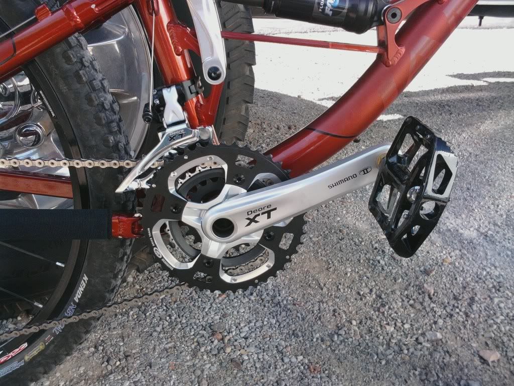

    The Shimano 3 x 9 XT crankset weighs in at 850g. With that and a XT M771 (@ 155g) front derailleur I might be able to get to an even 29 lbs. With some carbon bars I might be able to get the weight down to 28.5 lbs, and a set of Mavic Crossmax's should get it just over 28 lbs. I think I'll be happy there and be done with this build.

    My new parts came today: an XT crankset and XT front derailleur. New cranks are 853g, old ones were 1050g. The new derailleur weighed in at 160g, and the old one was 171g. The bike now weighs in at an even 29 lbs.
    The original derailleur is going on my other Jamis since the old one on it is getting wobbly. I'm not sure what to do with the old cranks yet because the cranks on my other Jamis are 100g lighter than what came on the XCT.
    This should be the end of my build for a while. I hope to get some good riding in this summer.
