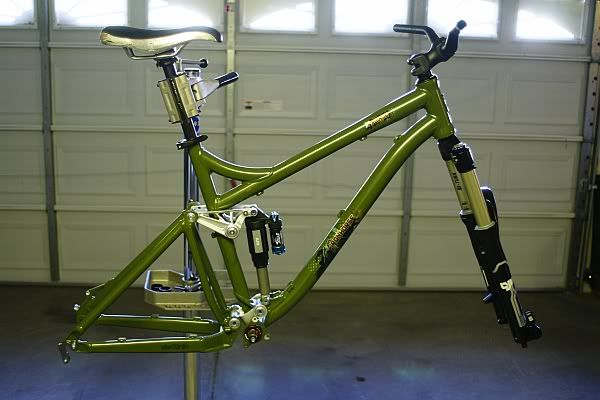

    As I've eluded to in a previous post, I am building a 6point6 from the ground up, with a mixture of new & used components. I couldn't resist the sweet closeout deal that RS was offering, and the timing was perfect since my previous mtb frame broke on a ride. The component list so far includes the following:
    Frame - IronHorse 6point6 (duh)
    Fork - Rock Shox Lyrik Solo Air, 160mm travel
    Rims - Mavic 823
    Brakes - OG 4-pot Shimano XT-M755 front, XT-M756 rear
    Rear Hub - Hadley Titanium
    Cassette - Sram X9
    Front Hub - Marzocchi 20mm thru-axle
    Shifters - Sram X9
    Rear dérailleur - Sram X9
    Front Derailleur - Unknown; was going to use one I had, but it doesn't fit - any suggestions??
    Crankset - OG Isis Race Face Turbine forged w/ FSA internal bb
    Chainguide - Blackspire Stinger
    Seatpost - OG Thompson 27.2mm w/ spacer
    Saddle - Not sure yet, but I have two WTB saddles on hand to choose from
    I'll update the list above as I continue with the build.
    A couple issues I've noticed so far:

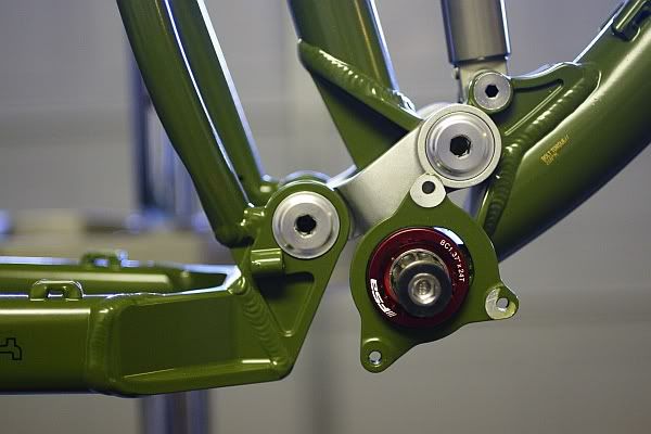

    - The top bolt clearance on the ISCG mount is minimal. The bolts that came with the Blackspire are 17mm long. Based on measuring the area, it looks like I can only get a 14mm bolt in there without causing interference issues.
    - The front dérailleur that I had from my old bike (Turner 5 spot) will not fit, no matter how I try. It is an older Shimano LX model, but its served me faithfully through several bikes. Not sure what FD people are running on this frame, but as soon as I finish typing this, I am going to do some searching. Anybody have some input on this?
    That's about it for now, my progress pictures are below. I'm hoping to finish most of the build this weekend, but with finals coming up, I might not get as far as I'd like. Anyway, enjoy the pics :-)

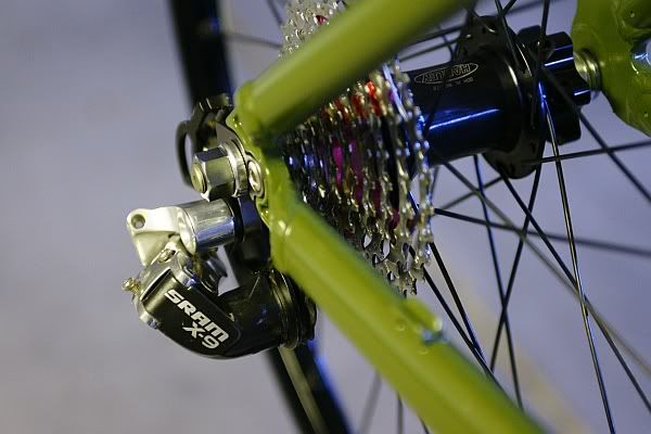

    I actually picked up the Saint front dérailleur at my LBS yesterday. I had to pick up a couple other parts, and they hooked me up pretty darn good.

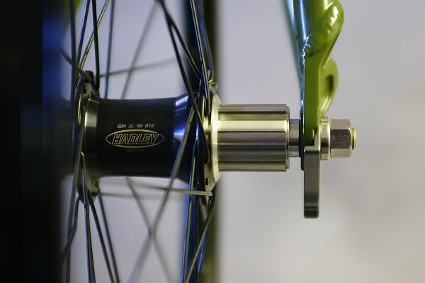

    As far as the rear axle goes, the quick-release model that came with the bike was a bit weak IMO, and didn't offer enough support to the frame. The bolt-on that is on there now is super strong, and pretty light as well. I don't really mind the bolt-on vs. QR, especially if its going to be strong & reliable.
    Arizona beats the hell out of bikes, and I'm mostly concerned about reliability at this point. If it takes me an extra minute to change out a flat once in a while, so be it, small price to pay.

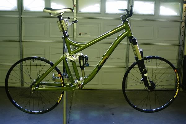

    Anyway, here's the update. I was in a bit of a hurry, so the pics didn't come out as clear as I'd hoped, but I'll be taking a nice series of pics once the bike is dialed in. I have installed the rest of the parts that were missing as of my last bike-related post in this thread The bike is now officially complete, but has yet to be dialed in. I've got the rear derailleur dialed in, as well as some of the geometry. I still have to completely bleed the rear brake & dial in the front der. I'm going to wait until I can get out on the trails to dial in the suspension settings.
    I actually took the bike for a quick spin around the block, and everything feels pretty good so far. I can't believe how balanced the frame feels. Very easy to wheelie/manual, and very responsive. Granted, I haven't gotten it on a trail yet, but still...
