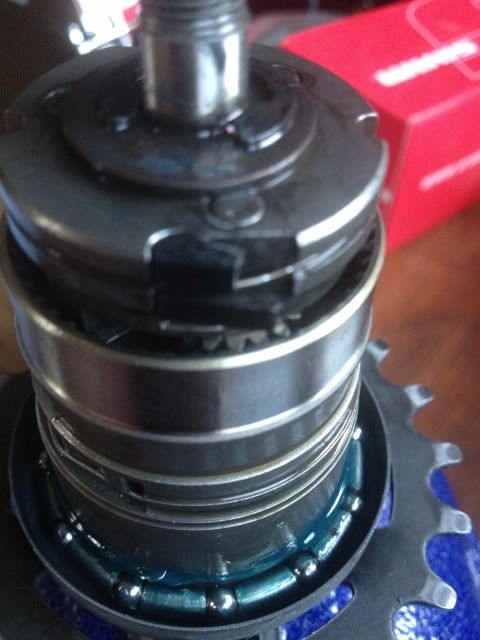

    The hub worked fine for the rest of the ride, so I didn't think much of it. When I tore it down later, here is what I found,
    Good pawl
    Broken pawl
    I'm having trouble finding parts for this hub. So I robbed a pawl from my Automatix hub, they are the same.

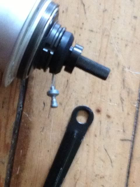

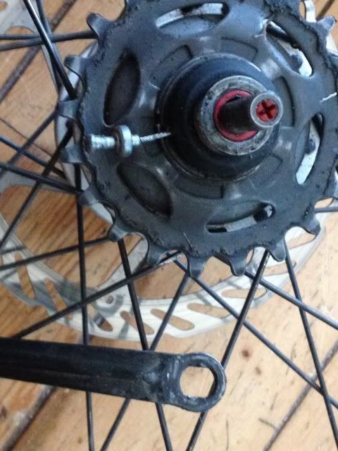

    The 1st lap I had to stop 3 times to reposition the axle/shift arm. The axle cannot be allowed to rotate. If it does, the shift arm turns up towards the chain, stretching the shift cable, putting the hub into 2nd or 3rd, and you can't downshift. If it rotates further, the shift cable pops off and you're stuck in 1st, spinning and no more shifting. The axle nuts have to be kept really tight.
    Here, my shift arm, keyed to the axle's flats, is getting a bit chewed up compared to the new one.
    New,
    The hub's innards are still clean. But the cog, held on with a spring clip, is getting really sloppy.

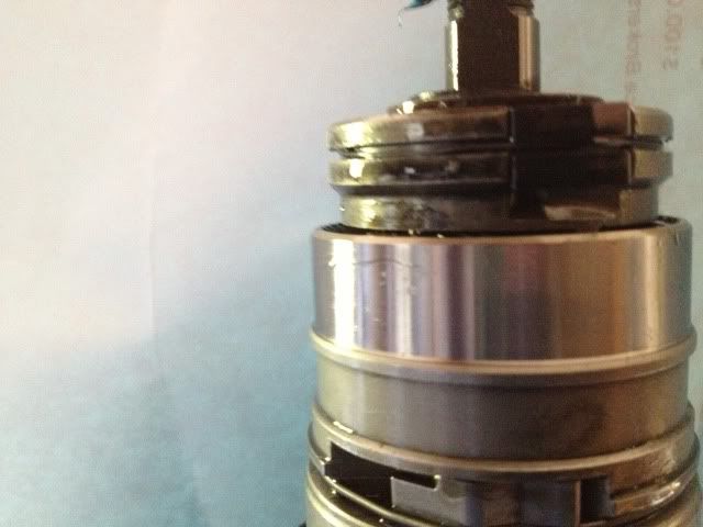

    Here I noticed the pawls are wearing on that outside tooth again. Thats the one that broke off earlier.

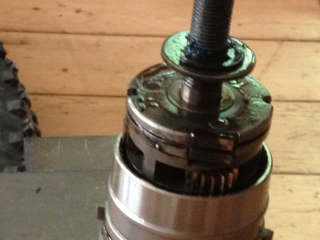

    Shortly after my last post, while climbing a short, but steep little trail bit, the hub went crack.
    It wouldn't shift anymore, stuck in low, and if I pedalled really light, I could get some engagement and drive, and made it home. I could hear crunching going on inside.

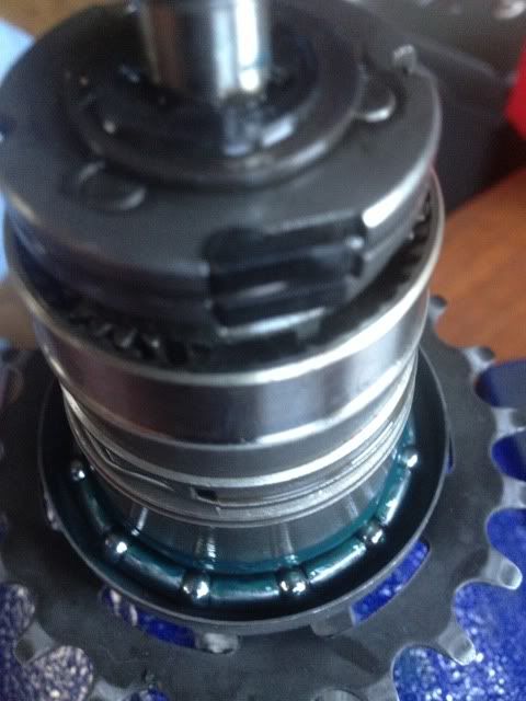

    Here's what I found when I slid the hub shell off.
    The e-clip and washer were pushed onto the threaded part of the axle.
    Taking that off, I pulled some gears out.
    The small bits in the center are whats left of some pins or pawls that may be whats needed to engage or shift gears.

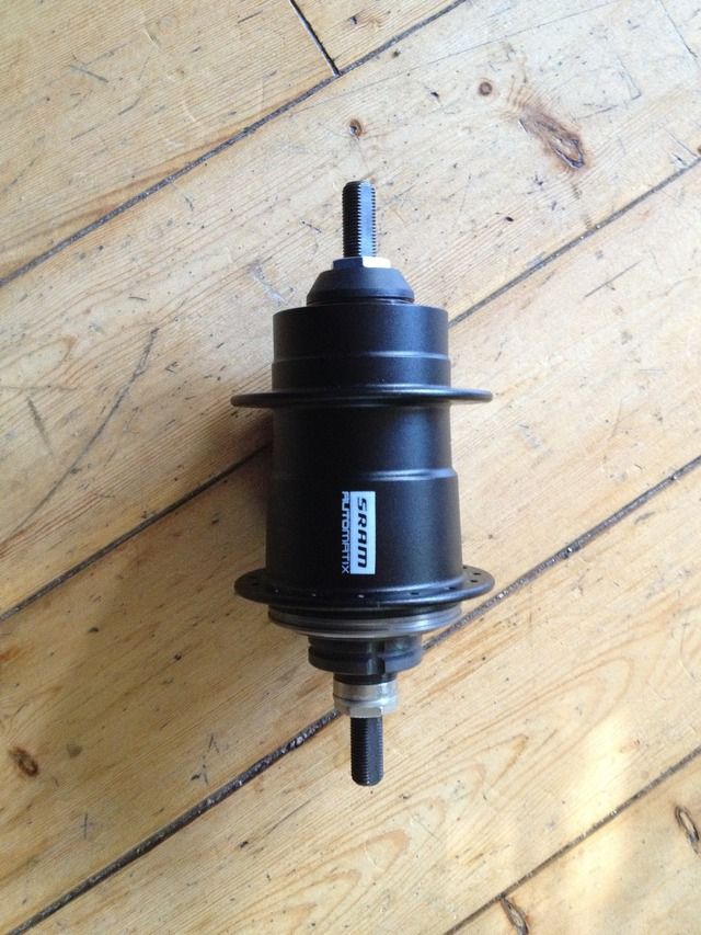

    At it again. A SRAM Automatix, 32H, 135mm spacing, and disc brake. Will follow up after I build it up and ride it awhile.
