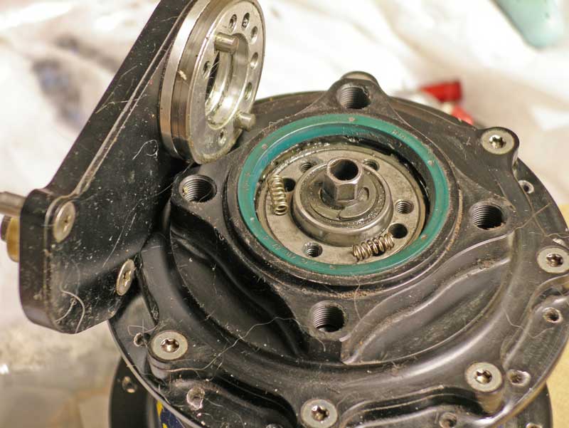

    I like swift's cable suggestion. I've had that happen, too -- where the cable is under so much tension that the shift lands you on the cusp of a shift detent rather than firmly in it.
    Two items that seem to cause the regular trouble among Speedhub users: overfilling the oil, and losing one or both off the detent springs nestled underneath the External Shifter mechanism.
    Too much oil will gum up the works, and can lead so some funky shifting as well as a messy puddle on the floor. Rohloff has three times modified their oil change procedures to reduce the amount of oil that should be going back in to the hub. They're down to about 15mL now, with the assumption that 12mL is sticking to the internals. A bone dry, factor fresh hub takes 20mL.
    If you've removed the External Shifter for any reason, there's a good chance you lost one or both of the tiny springs under it. They apparently lead to shifting woes, although if I recall correctly, it's more apt to be ghost shifts to neutral.
    <img src="http://www.booboodog.net/images/speedhub-1.jpg">
    <i>Edit: BTW, the hub pictured above was an eBay steal -- the seller throught the internals were shot due to wonky shifting. I took a gamble ($300 buy-it-now), and sure enough, all it was missing was the two detent springs.<i>
