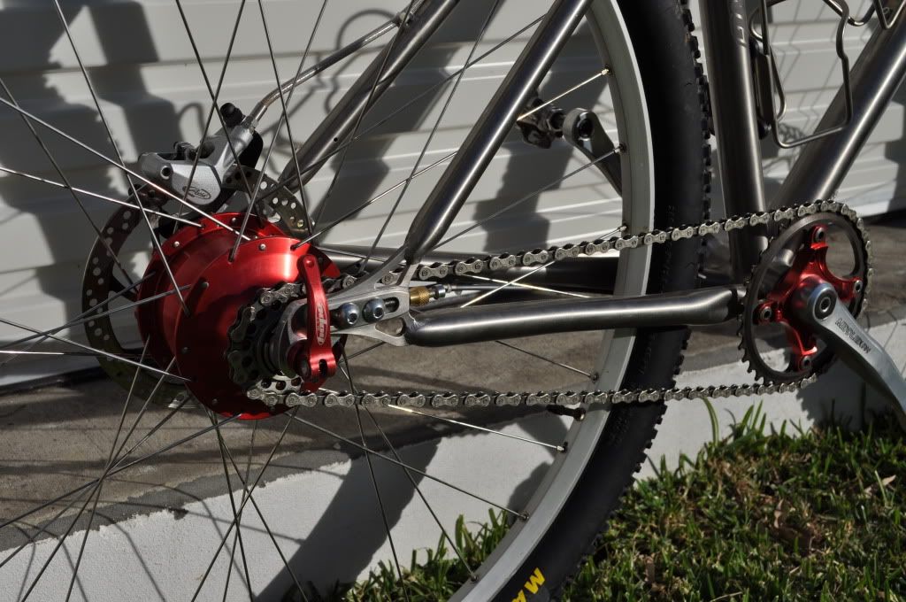

    My preference for a custom Rohloff-able frame is an OEM1 dropout, with derailleur hanger, and an eBB.
    This is what one of our frames looks like with the Rohloff installed, it has a derailleur hanger on the drive side, which has never seen a derailleur. The dropout was fab'ed from a Sub-11 (Surly) track mount.
    Here is a close up of a more recent one, in Single-Speed mode.
    You should find out if your frame builder likes using am eBB or sliders. eBB shell tolerances need to be tight for creak free performance, which requires the correct tools. If you go with sliders, I prefer the Rohloff versions, although you can make the Paragons work with better hardware.

    Quote Originally Posted by itsdoable View Post
    What's the name of the company that produced the red bike frame above? I love that design with the ext gear mech on top of the frame, safe from rocks and tree stumps.

    Quote Originally Posted by nosivad_bor View Post
    My first post so i cant IM or post links or pictures.
    Rob
    "byStickel" custom frame from Steve Stickel.
