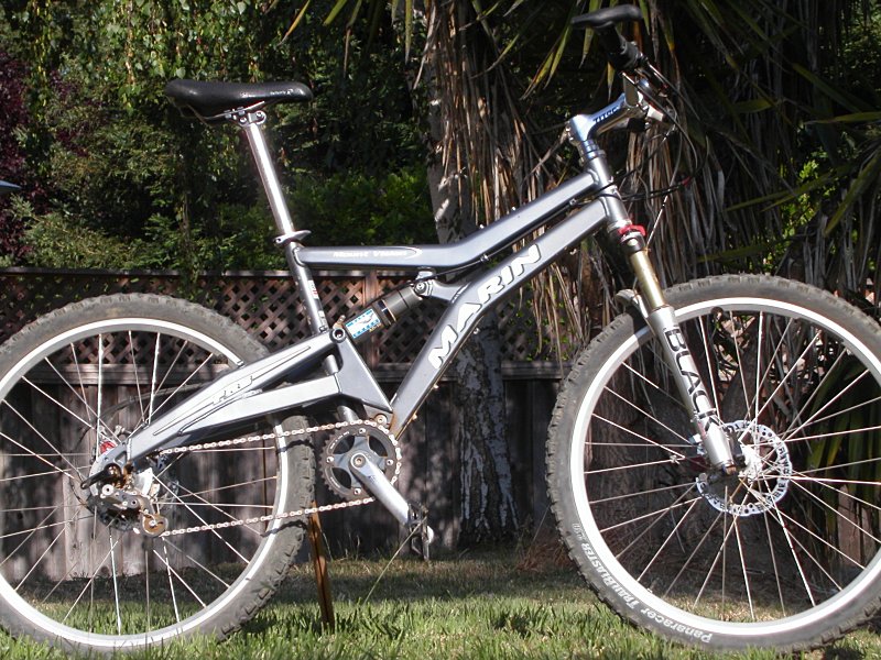

    My wife rode a 2001 Marin Mount Vision that I built up with a Speedhub, no problem. I can't see the pic you posted, but I believe '04 was the year Marin transitioned from the single pivot to the Quad-Link suspension. However, that should have no impact on your ability to 'hub the bike.
    In her case, I used Rohloff's Speedbone for anti-torque duties, but like Swift mentioned, a Monkeybone ought to work well, too, with a cleaner look.
    Here are a couple of piccies of her build:
    <img src="http://www.booboodog.net/images/mtvis-sh(1).jpg">
    <img src="http://www.booboodog.net/images/mvsh.jpg">
    A major benefit of the Speedhub on a single pivot design is the ability to optimize the chainring size to the pivot location, to cancel out any unwanted effects of the chain pulling on the suspension. With the chain aligned with the pivot, it's a fairly neutral pedaler without the need for fancy damping on the shock.
    In the case of multi-link setups, the proper gear ratio gets a little more complicated, but you can usually rely on something between 32 and 38T hitting the sweet spot.

    I can't recall if I left the Marin as pictured, or if I ran a Rohloff chain guide.
    I can tell you that I attempted no chain guide on a full-suspension Iron Horse Hollowpoint, and was successful for a number of rides but then dropped the chain three times in one ride. Same again on an MkIII, except this time the chain bent my steel chainring AND spider, landing my crank in the recycling bin.
    So every full suspension bike I've built with a Speedhub has a chainguide on it.
