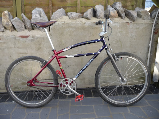

    Aha Inspiration
    The Skull Skates bars seem great - Nice old school shape.
    But the S&Ms are a little narrower at the bottom, so I went with those.
    I prefer the look slightly and the narrower bottom part is a bit more "knee-friendly".
    Re. stem: Mine's a generic 4-bolt BMX type. 1/18th clamp-on. And, of course, the bar clamp fits the S&M BMX bars, so no shims etc. needed.
    Re. 8 inch bars: Yeah, I'd say they might be a bit too tall. I *think* my S&M bars are the 6-inch ones. With a zero-rise stem they're a bit too tall. Might rotate them forwards and down a touch. Even small changes make a big difference to ride position.
    There's a slightly flatter 5.75 S&M version, which might be better - But most of us don't have the luxury of trying before buying.
    If you want inspiration for pimping the Aha, try the Cook Bros section at BMX Museum.
    There are probably 20+ obvious differences between the 2 frames, but there's no denying the Aha is basically a CBR clone, so this page will give you some rough ideas of how the Aha might look with different set-ups.
    http://bmxmuseum.com/bikes/cooks_brothers/
    A crappy picture of my Aha:
