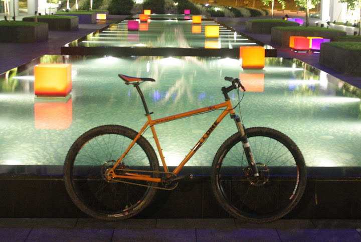

    I also posted this in the "29er Rigid" pic thread. Enjoy!
    This has been my daily commuter for 2 months now, but I've done the quick switch to offroad mode (remove fenders, rack and 50mm slicks, etc). I've really liked the Nuvinci on the road. Time to give it a proper test.
    Maiden trail ride is tomorrow.
    <Edit> Post ride report. Excellent offroad capabilities! Great climber, fun handling. I look forward to more. I replaced the Brooks B-17N with a 143mm Specialized Phenom Gel - MUCH better!!!!!!!!!!!!!
    The clearance with 2.4 Ardents. Not bad.
