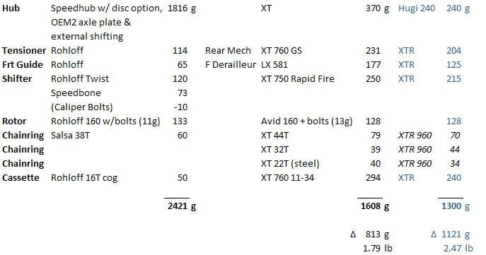

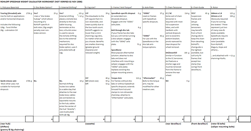

    Reputation: Speedub.Nate's Avatar
    9,145
    Here are the numbers you're looking for, Mike. There was enough of this "oh, about X pounds" stuff going around that I visited Rohloff's Oakland shop one day with my digital scale & notepad in hand, and proceeded to weigh just about everything on their shelves.
    I'm pretty confident in the numbers, but even if for some reason they're not spot on, based on what some other gram counters have come up with, they're definitely in the ballpark. You should be able to cobble together an accurate weight for just about any hub set up.
    Not included are weights of derailleur components of choice, which anybody can lookup on http://weightweenies.starbike.com/ . I've provided some sample weights below my worksheet.
    Click on image for full-sized, printable version.
    <a href="http://www.booboodog.net/images/speedhub-weight-worksheet.gif"><img src="http://www.booboodog.net/images/speedhub-weight-worksheet-s.gif" border=1></a>
    <img src="http://www.booboodog.net/images/speedhub-weight-xt.gif">
