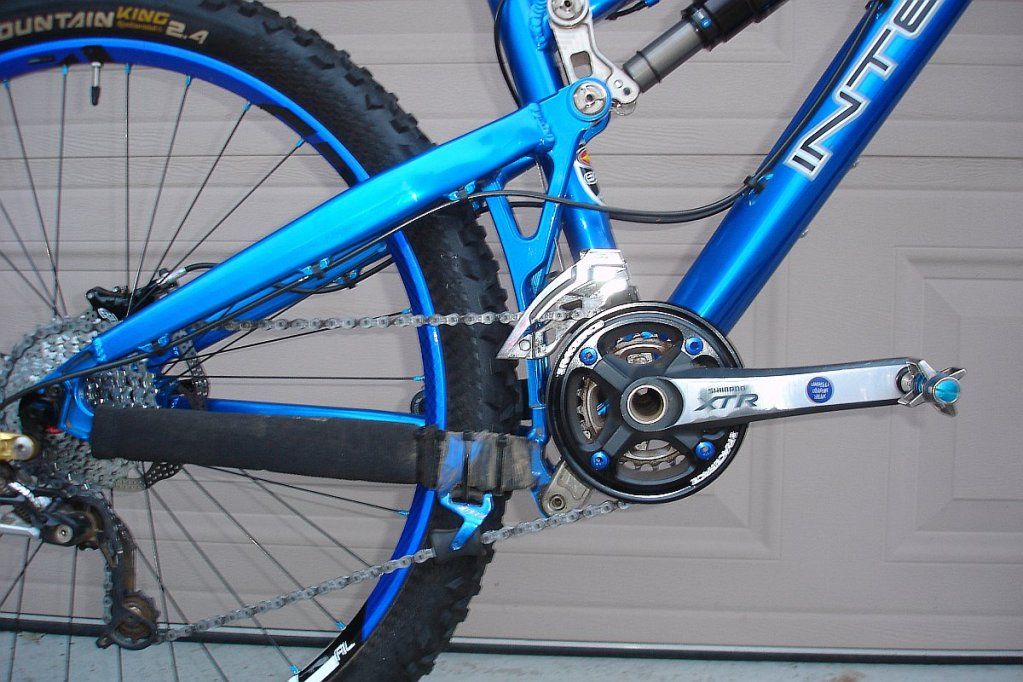

    PROJECT: Tracer 2 converted to 650b
    I can't believe I did this because I really loved my 26" Tracer 2 and the Haven wheels were fantastic, but curiosity got the better of me and decided to give the 27.5" conversion kit a try with some new 650b FLOW EX rims built on Hope 2 EVO hubs. Finally got it all put together tonight along with a new set of Hope M4's and must say it feels freaking awesome.
    I was really afraid it would lose the spunky playfulness of my 26" setup but after a few tight compression turns and a little curb hopping it feels better than ever. I'm yet to get it on my regular trail to see how it really compares to the previous setup, but early indications are very promising. Like I said, I had no complaints before, but at 6'1" it just feels a little more proportioned and seems to now have a little something extra it was missing before - this definitely feels like it could be the ultimate trail killer for me.
    The head angle registers the same at 67 deg but seems to toggle between 66 & 67 where before it would jump between 67 & 68. The wheelbase grew from right about 46" to and even 46.25" now and the weight is almost identical at 31.85 lbs (including dropper post and pedals)
    The conversion went so perfectly smooth and everything went together with the precision of a Swiss watch - no clearance issues at all with my stock Fox 36 Talas and Neo Moto 2.3's. I'll post a better update once i get some quality trail time with her, but so far it feels like it's going to be an AM beast!

    Just make sure the wheels don't contact the frame or fork crown. I would deflate the shock and fork and completely bottom them out to see if there are any interferences.
    Where did the BB end up?

    Thanks iRider,
    Just curious, I've heard a few people recommend checking the front bottom out clearance, but if the arch, lowers and thru axle mounts are all one piece how could arch clearance change? Or come to think about it, is the concern with the bottom arch or the top crown? Maybe I'm looking at the wrong spot.
    It is about the fork crown, not the arch. You can clearly see that you have enough space at the arch, but if your tire hits the crown while you ride an OTB is inevitable.

    OTB for sure. I guess ya don't realize a 160mm fork compresses that much when you're just looking at in in static position. That would really suck to stick a landing only to end up doing a swan dive because the tire bottoms the crown LOL. From what I've read it should be OK but I'll deflate the forks to be safe - thanks.

    The Fox 36 Talas does not have any clearance issues with the Pacenti Neo Moto 2.3's. I have heard others say that the Fox 36 will support just about all 650b tires, but I have only tried the 2.3 NM mounted on some FLOW EX rims (mounted up really easy and air-tight so far)

    I bought the dropouts from Fanatik Bike. You need both sides and the brake adapter. Just make sure the new rear hub is 12x142. Very easy to do the conversion yourself once you get the right parts. PM me if you need more specifics.

    I measured the before and after head angle as close as I could and they both registered 67 but maybe a half degree slacker according to the iphone Clinometer. I don't feel any difference at all with the seat tube, in fact I didn't find it necessary to adjust the seat at all. Although the BB is a little on the high side in static position, it doesn't feel any more top heavy as a result - I was very skeptical about that too but am very happy it is a non-issue for me. I really like it so far. Hope this helps.

    Sorry for lagging on a ride report, but I finally got some quality time on the T2 650b this past weekend up in Big Bear. Mostly some twisty fire roads, but also quite a bit of off-trail mini freeride with some small boulder drops and stump jumping and finally a fast downhill banked quad trail for some speed tests.
    Not sure what to say, but for me the best trail bike just got even better with the conversion. I was very hesitant to do it because I really like a spunky playful bike and feel drawn towards every obstacle I can find and didn't want the bulky feeling that I get with the few 9ers I have ridden. Super happy to report that the bike feels as fun and lively as ever in the techy type stuff and jumps like a champ. The biggest difference I noticed is a more stable platform to crank on when grinding up a bumpy climb and a noticeably better roller on the short hilly pavement ride to the trail.
    A lot of people say the whole 27.5 thing is all psychological, but I know my T2 like the back of my hand and can truly get an "apples to apples" comparison rather than jumping on a brand new 27.5 bike. The reason I did the conversion is because I'll be doing most of my riding up in the mountains from now on and I wanted a bike tailor made for longer rides that can handle everything from XC to light DH - and I think I now found the perfect setup for that kind of riding.
    tmeyer - sorry I can't answer your question with an exact BB height because I left the rig up at the cabin, but I thought it was right about 14" - don't let that number fool you though. I was riding in 6.25" the whole time with about an inch of sag and couldn't tell any difference in a slightly higher BB - I am very conscious of a low CG and would blow up the experiment if I couldn't "drive" the bike the way I like to. Non issue for me.

    No issues at all with front or rear clearance. I'm running Flow EX with Pancenti Neo Moto and have about 10mm clearance all around. I'm pretty sure I would have felt any rubbing issues by now if there were any.

    I didn't do a pre-conversion BB measurement but it sits about 14" now. Not a noticeable difference IMO - I hate bikes that feel top-heavy and the T2 conversion certainly does not feel out of balance in the slightest.

    Original setup was a Fox 36 Vanilla RC coil fork up front and a Pushed Fox Float RP23 out back. 1x10 hybrid drivetrain with a 30T RaceFace Narrow/Wide front ring and a 11-42 rear 10 speed cassette courtesy of a SRAM PG-1070 with a 42T cog and a Shimano XT Shadow+ rear D. Original wheels were also Easton Havens with 2.4 Schwalbe Rocket Rons.
    After a couple months or riding I was definitely loving the bike. It was a fun and fairly light setup at 30 lbs. However, at 200+ lbs fully loaded I needed stiffer wheels and more durable tires for my riding. Since I was planning to get a nice wheelset built up anyways I just let curiosity get the best of me and decided to just jump into the 27.5 conversion.
    27.5 Conversion:
    - Chris King hubs laced up to Derby 650B x 40mm carbon rims w/Schwalbe Nobby Nics 27.5x2.35 tires
    - Intense 27.5 dropouts and brake adapter from JensonUSA (best price at the time at ~$150)
    - Cane Creek Double XC zero-stack headset to try and keep the front end height in check (also considering lowering the fork to 150mm)
    New wheelset weight came in at 1740g which is just under the 1750g for my Easten Haven 26" wheels that these replaced. Since I switched from 26x2.4 Rocket Rons to 27.5x2.35 Nobby Nics I also added over half a pound at the tires but a much more appropriate choice of tires anyways.
    Ride-wise, the bike still rocks but I can't really say there is any noticeable difference from riding with 26" wheels and I mostly mean that in a positive way. Cornering through tight switchbacks there does not feel to be any loss in agility. Climbing and descending mostly felt unchanged. I was also worried about raising BB-height but it isn't really noticeable there either. All that said, I got 18 Strava PRs last weekend on a trail that I ride pretty regularly! Mostly on the downhill stuff but also on one of the longer climbs. Must be something to this 27.5 stuff but it certainly isn't revolutionary.
    Here's the pics...
    PROJECT:  Tracer 2 converted to 650b-image%5B5%5D.jpgPROJECT:  Tracer 2 converted to 650b-image%5B6%5D.jpgPROJECT:  Tracer 2 converted to 650b-image%5B7%5D.jpgPROJECT:  Tracer 2 converted to 650b-image%5B8%5D.jpg

    Might as well run 203 rotors. Mine worked fine with them. I powder coated my Tracer 2 and updated the decals. Then left the bike with my family in British Columbia to be my Whistler Pig.
    PROJECT:  Tracer 2 converted to 650b-img_2562.jpg
    PROJECT:  Tracer 2 converted to 650b-img_2561.jpgPROJECT:  Tracer 2 converted to 650b-img_2499.jpg
    Attached Thumbnails Attached Thumbnails PROJECT:  Tracer 2 converted to 650b-img_2499.jpg
