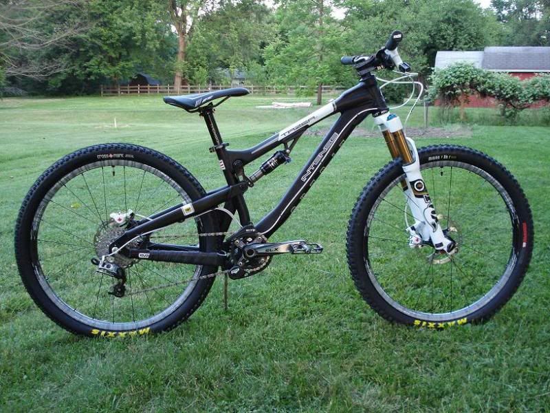

    New Tazer VP build
    Just finished it!
    Tazer VP small
    '12 float 36 at 100mm/ Chris King headset
    Easton Havoc wheelset/stem/carbon bars
    Formula RX's, 180mm Ice tech rotors
    170mm SLX crank/ Blackspire pedals
    Minion DHF 2.35/Crossmark 2.1
    Thomson post
    MRP mini g2 medium angle
    X9 short cage/ x7 shifter
    Coming soon:
    pg950 11-26 cassette
    KMC sl gold chain
    Selle Italia slr saddle
    X9 ball bearing shifter

    Walter, hows does the asymetrical rear triangle work regarding wheel setup ?
    120
    In terms of what? I run the havocs with a Hadley 135x12 bolt. Perfect setup. Plenty of clearance to run a big tire. Ive had a Ardent 2.35 on the back already with tons of room to spare.
    Reputation: -jes's Avatar
    147
    Sorry Walter should have explained what I was thinking, which was the asymetrical design was produced to allow the wheel to be built with the rim centred to the hub flanges (stronger) which would mean the dropouts are moved to the drive side of the frame.
    This would mean having a wheel built up for the frame or tweaking an existing wheel.
    But looking at your photos I just thinking I've mis-understood what Intense mean and they are referencing the bracing on the non drive side so I can just slot a standard built wheel in.
    Also is the black FS frame anodized the same as the HT or is it a painted ?
    120
    Im sure the idea was the latter. The finish is a textured powdercoat. Cleans up pretty easily, tho i wish it was anodized.
