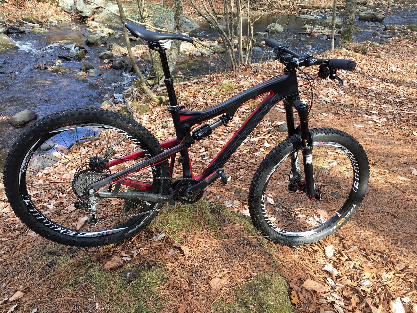

    I have a Carbine SL with a longer shock to get the same 5.5-6" travel as the standard Carbine. With a 150mm Revelation up front, 20mm maxle & a RWS axle in the rear, it's a 25lb sweetheart of a ride!
    To answer the OP's question, there are 3 Carbines.
    1) Std Carbine, which can be 26" or 27.5" with different G1 dropout options.
    2) Carbine SL, Which is a dedicated 26", open dropout for QR or RWS 135mm fitment. Comes stock with a shorter travel rear shock & designed for a 120mm front.
    3) Carbine 29, dedicated wagon-wheeler with G1 dropouts for adaptability to different hub standards.

    You're correct about the bike handling a 150. The rear shock dimensions are simply the same shock as the Carbine. So 7.875" x 2.25". Still amazed by how much better this climbs than my Tracer VP did, and it corners like it's on rails! The Carbine SL's original shock was 7.5" x 2".
    Edit; And since the frame & linkage are exactly the same geometry, there are absolutely NO interference problems!

    Yes, these are eye to eye lengths. Trust me it fits. It'll raise the rear up a tad, but will also travel further due to the longer stroke. All you're doing is getting regular Carbine travel out of an SL. The frame and swingarm come from the same molds as the standard Carbine, and the carbon link is the exact same geometry as the aluminum link on the other bike. I calculate the travel by adding the extra 11-12% of the longer stroke shock to wheel travel. 135 + 11% = 151.

    The extra travel is always good! I can run it with a little more sag and really have it plush in mid travel without losing ANY efficiency. Rides like a dream.
    (Personal preference; I tend to run heavier damping to control wallowing during trail rides, but back off rebound and compression for Enduro style rides)

    Direct from the source.... Carbine SL uses 7.875 x 2.0"

    Of course Sam is correct. My stock Fox shock is a 7.875 x 50mm. I replaced it with a 7.875 x 57. Fits great with no interference.

    My setup is similar to hobine. I ride a SL with a longer stroke CCDB inline 7.875x2.25 (instead of 2.0). Fits perfectly and will get you around 150mm of travel just like the standard carbine.

    I really like the way my SL rides with the Inline. I notice a big difference on the climbs, much less wallow while still being plusher on the little stuff. I almost never use the climb switch, only on long steep fire roads. CC customer service is very good. When my original Inline started chirping and loosing dampening, they sent me a new shock and a return label for the old one.
    If your running a 150 fork, go for the longer 2.25 stroke rear shock.
