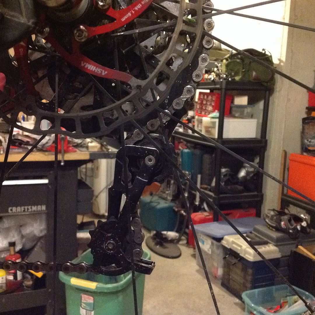

    Quote Originally Posted by ashaw View Post
    Hobine, can you post up a pic of your cassette/RD clearance with chain on 42? Just curious as to your setup. I'm getting some skipping under load on the 42.
    Have you adjusted the high and low stops? How about the D-hanger alignment? I found on my SL the hanger alignment was off quite a bit and everything improved once I aligned it. Even new hangers can be off.
    Pics aren't great with the crappy basement lighting but the clearance is only a few mm.
