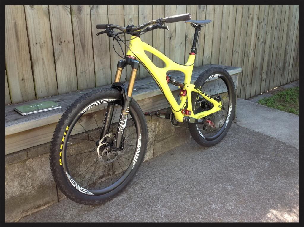

    Quote Originally Posted by Maverick005 View Post
    Here she is definitley worth the wait, thanx to my awesome LBS/ for getting her together for me today, wouldnt let me leave lol and also to our importer who was also awesome, cheers guys.
    Frame: IBIS Mojo HD Large
    Colour & Mode: Vitamin P red links /140mm flip chips
    Headset: Chris King inset Red
    Fork: Fox 34 Float ctd Kashima set @ 150mm
    Shock: Fox Ctd Kashima
    Bar: Chromag OSX
    Stem: Chromag Ranger black 50mm
    Grips: Odi TLD
    Seatpost: RockShox Reverb dropper post
    Seat: SDG Duster green (temp one on at mo only blem till in stock)
    Shifters: Sram XX1 rear
    Cranks: Sram XX1 175mm carbon
    Chain ring: Sram XX1 34t
    Chain: Sram XX1 11spd
    Cassette: Sram XX1 9/42 t
    Rear D: Sram XX1
    Brakes: Avid Trail XO 180/180
    Wheels: Enve's /Chris King 15mm front 32h / rear DT 240s, 142x12
    XX1 XD driver hub shell
    Tires: Maxxis
    Front Maxxis Ardent 2.25, rear Maxxis Icon 2.2 exc/exo I run tubes, maxxis superlight 0.87mm Presta valves.
    Pedals: Crank Bros Mallet 3s
    Also thanx to Hans for putting up with my pms
    but I do appreciate the replies gave me lots of confidence to hang in there and wait.

    Hi Carlos, cheers mate,
    Ive posted details here, hope this helps, Mavs XX1 setup
    Cheers Mav

    Quote Originally Posted by Carlos Andres Velez View Post
    Hello Maverick,
    Nice rig, I am going to order a sram xx1 group for my Ibis HD 160mm, but firts I would like to be sure about the size of the cranks GXP Q156 or Q168, and also if the frame needs a modification to install the group (Based on your experience)?
    Thank you for your attention and time, waiting for your reply.
    Regards,
    Carlos Vélez
    You can run either. I am running 156 without issue.

  24. #1899
    Reputation: jimarin's Avatar
    Mar 2005
    447
    Here mine. Just added the carbon haven's. 31.15 lbs as she sits.
    Large Mojo Frame w db air
    Fox 36 van rc2 160
    Haven Carbon wheels
    xo cranks
    xtr shadow plus rear
    xt shifters, front mech, and brakes w icetech 180 160
    raceface sixc bars and atlas stem
    lev post
    mountain king 2 protection 2.4 front, trail king 2.2 ust black chili rear
  25. #1900
    161
    Now that is a sweet ride!
