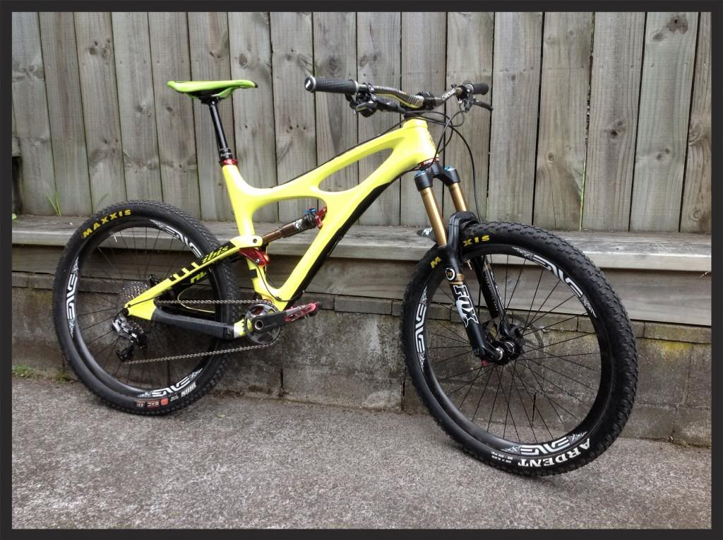

    Just finished mine. This thing is a beast.

    Here she is definitley worth the wait, thanx to my awesome LBS/ for getting her together for me today, wouldnt let me leave lol and also to our importer who was also awesome, cheers guys.
    Frame: IBIS Mojo HD Large
    Colour & Mode: Vitamin P red links /140mm flip chips
    Headset: Chris King inset Red
    Fork: Fox 34 Float ctd Kashima set @ 150mm
    Shock: Fox Ctd Kashima
    Bar: Chromag OSX
    Stem: Chromag Ranger black 50mm
    Grips: Odi TLD
    Seatpost: RockShox Reverb dropper post
    Seat: SDG Duster green (temp one on at mo only blem till in stock)
    Shifters: Sram XX1 rear
    Cranks: Sram XX1 175mm carbon
    Chain ring: Sram XX1 34t
    Chain: Sram XX1 11spd
    Cassette: Sram XX1 9/42 t
    Rear D: Sram XX1
    Brakes: Avid Trail XO 180/180
    Wheels: Enve's /Chris King 15mm front 32h / rear DT 240s, 142x12
    XX1 XD driver hub shell
    Tires: Maxxis
    Front Maxxis Ardent 2.25, rear Maxxis Icon 2.2 exc/exo I run tubes, maxxis superlight 0.87mm Presta valves.
    Pedals: Crank Bros Mallet 3s
    Also thanx to Hans for putting up with my pms
    but I do appreciate the replies gave me lots of confidence to hang in there and wait.

    Amazing build, Maverick!

    Quote Originally Posted by marcoton21 View Post
    Cheers marcoton.
    The bike got its maiden shake down ride this afternoon 3hrs of summer evening blast, felt great, XX1 is amazing shifts so fast and you can take adantage of the dwl and hammer it, Im sure I was supposed to be running a 34t front ring but it has a 32t feels a bit small to me, would like to be riding a 34t but easy to change, then my ratios for my home riding should be sweet, the HD is so plush and ramps up very nicley towards the end of the stroke, for me even at 140 it slays my trails very impressive, am so loving the color combo looks stunning in person, defintiely draws attention not sure if thats a good thing or not, Im not worried about it just ride huh.

    Quote Originally Posted by Maverick005 View Post
    Bar: Chromag OSX
    Grips: Odi TLD
    Rear D: Sram XX1
    how tall are you? i'm interested on a HD but i'm trouble with the size

    Quote Originally Posted by wally73 View Post
    5'11.5" Im usually in-between sizes and I like large frames longer wheelbases the Mojo just fits me well, it was a big factor in choosing the Ibis as well.
    Loving the bike so far still getting tuned in doing the fun bit.
    Cheers.
    Slight update, my seat arived and its sweet long narrow and super supportive which = comfy for me, not harsh hard but hard enough.
