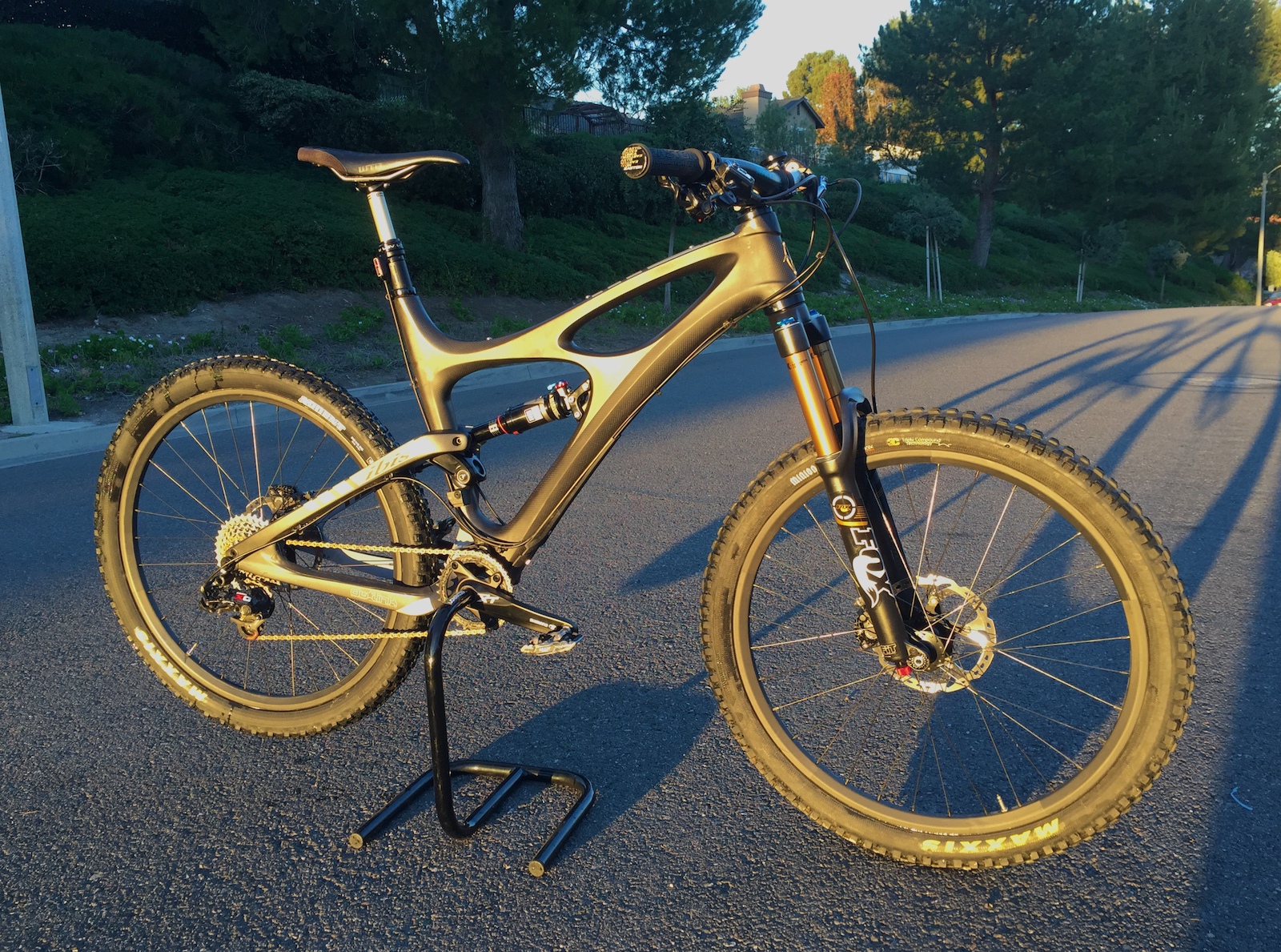

    My Ibis HD
    I decided to give the HD a little love this weekend. Brand new enduro bearings in all the pivots, and both hubs.
    I thought it looked so good all cleaned up that I decided I had to take some pictures and post it up.
    Frame: Ibis HD, Medium Black (enduro pivot bearing upgrade)
    Rear Shock: Fox DHX Air
    Fork: Marzocchi 55RC3 Ti
    Headset: Cane Creek 110
    Stem: Thompson X-4 50mm
    Bar: Enve DH (cut to 780mm)
    Seat post: Rock Shox Reverb
    Saddle: Chromag Trailmaster LTD
    Grips: ODI Troy Lee Designs
    Shifter: Sram X01
    Rear Der: Sram X01
    Cassette: Sram X01 10-42
    Chain: Sram XX1
    Bottom Bracket: Chris King Gold
    Crank: Shimano XTR-980
    Chainring: Sram X01 32t
    Brakes: Shimano Saint front and rear 203 rotors
    Wheels: Gold Hadley Hubs, Stans Flow rims 32h black 14/15guage black brass nipples
    Tires: WTB Vigalante front, Wolverine Rear tubeless.
    *The bike was purchased at The Bike Company in Lake Forest, CA

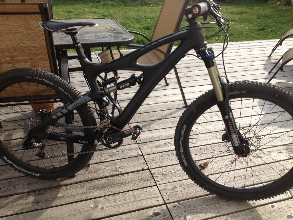

    juu-zo
    Some updates since march.
    Frame: Ibis Mojo HD 140 Vitamin P (Small)
    Fork: Rock Shox Pike 160mm
    Shox: Fox Float RP23 CTD Boost Valve (kashima)
    Grips: Lizard Skin DSP
    Handlebar: Easton Haven carbon 711mm
    Stem: Easton Haven 70 mm
    Headset: Hope mixed tapered
    Shifter: Sram XO1 with matshi matchmaker
    Brakes: Shimano XT M785
    Discs: Shimano XT 180mm and 160mm
    Cranks: Sram XO1 34t
    Pedals: Shimano xt M780
    Rear derailleur: Sram XO1
    Cassette: Sram XG-1195 10-42t
    Chain: Sram PC-XX1
    Seatpost: Rock Shox Reverb
    Saddle: Selle Italia SLR TT
    Rims: Light-Bicycle Wide AM Hookles
    Hubs: DT Swiss 240s
    Spokes: DT Swiss Supercomp
    Nipples: DT Swiss brass
    Tires: Schwalbe Racing Ralph Snakeskin 2,25"
    Total weight: 12,13kg
    Attachment 907799
    Almost dream bike and build for me.

  • 03-29-2016
    starship303
    Bit of an update on me keeping the HD alive and healthy. Here it is in 650b glory (with new M8000 1x11 drivetrain). Wheels as previously mentioned are Light Bicycle 35mm (30mm internal) carbon rims laced to DT Swiss 350 hubs, with the 36t ratchet upgrade installed. Light is the word too, quoted at 1480g!! Running HR2 27.5x2.3 up front and Ardent 27.5x2.25 out back, a setup I'm very familiar with in 26" guise....
    "Got Slack?" Testing the bottom out clearance...
    This is what the clearance looks like at the seat tube with a 27.5x2.25 Ardent... Not sure now if I can run offset bushings. Thoughts ??? To me thats about as close as you want to go without taking into account flex in the frame or wheels...
    Yes, my shock is bottomed out, i appear to have a bit of extra shaft ("that's what she said").
    Thinking I might need to turn it into an HDR650b and reduce the shock travel instead of using offset bushes to lower the BB. 😒 For the cost of one set of bushes maybe its worth a try??
    No ride report as this thing is yet to see the dirt unfortunately.

  • 05-17-2016
    starship303
    Well I finally had a chance to get out on the HD650b, and although there is still some fiddling to do with suspension setup, this thing felt great!
    [/URL]
    This was a brilliant chance to work out the differences just a wheel and fork change can make going from 26" to 27.5". I ran the same spec tyres (2.3 HR2 front, Ardent 2.25" rear) which also helped. Although I dropped a decent amount of weight from its previous 170/160 coil setup, its essentially now sitting at the same weight as it was in HD140 guise, the way I rode it for the majority of its life.
    Anyway below are some interesting observations...
    Parts changed:
    Fork - from a 2012 150mm Revelation RLT Ti 20mm maxle (or a 170mm Marzocchi 66RCX 20mm thru axle) to a 150mm Pike RCT3 Solo Air 15mm maxle lite.
    Wheels - from 26" Easton Haven to 27.5" LightBicycle 35mm ext (30mm int) AM carbon rims on DT Swiss 350's (with 36t star ratchet upgrade).
    Tyres - HR2 2.3 fr, Ardent 2.25 rr (same tyres just different dia.).
    Clearance:
    This it's an easy one - no clearance issues! Remember this is just a fork and wheel change, no other geometry was (yet) harmed in the making of this 6-fiddie... The guys at Ibis say it works set as a HD140 wothout any mods, and it's the thruth.
    Clearance on bottom out as posted previously... (with OEM HD140 limbo chips and shock)
    Acceleration:
    Due to the lighter wheelset (1480g vs 1650g) it was always going to accelerate a bit better, and it does! Physics may suggest that the larger wheel should slow it down in this department, but I guess wheel weight trumps wheel size in this case! Out of corners in particular I noticed the added acceleration. Combined with the lighter feeling front end it seemed to pop out of corners better than ever before! (heavier fork + lighter wheel seems to feel lighter than a lighter fork + heavier wheel of equivalent weight... If that makes sense? Makes sense from a physics perspective, lever arm/moment/etc).
    Cornering:
    On entry into and through the corner I could definitely feel additional grip. The salesmen are right! 😨😉 Of course, my rims are quite a bit wider so that could have attributed to the added grip as well, along with added stiffness of the wheels. One drawback I felt from this conversion was the higher BB. From memory mine measures bang on 14" static, so I was running a little more sag to compensate. It wasn't a deal breaker by any means, but it was there in the flatter corners. I had always planned on installing offset bushings to counter this (along with shortening the travel slightly, making it essentially an HDR), but wanted to test the bike first beforehand. Turns out, yep I prefer a lower BB. The added pedal clearance was however a bonus on a trail with lots of little rocky pedal snags. I could just motor through sections that I would have normally had to time my pedal stokes.
    Change of direction/playfulness/jumping:
    Wow! This was something I was a little worried about as I find the HD a very playful bike, its why I'm still riding it over 4 years later. I guess this all comes down to wheel weight, but the bike felt more playful than previous! Even jumping felt more comfortable, and that's coming from someone who tends to prefer keeping pretty close to terra firma.
    Climbing:
    Better through the rough climbs, no real disadvantage on smooth climbs. Not much else to say but win win!
    All in all, stoked! It should only get better from here with the Corset can to go in along with offset bushes! 😁
    Cheers
    *3o3

    I have a 2014 HDR 27.5 with the rockshox rtc3 front fork. Just bought the seals to service the fork and to change the travel to 150mm. Have any of you done this to your bike any noticeable difference, pros and cons?
  • 01-10-2017
    ictire
    Would anyone have rear wheel clearance pics of an HD running 27.5?
    Thanks.
  • 01-11-2017
    yem999
    Im running a maxxis ardent 2.25 front and rear and its clear but I personally wouldn't go bigger, seems like a rock can easily get lodged between.
  • 01-11-2017
    yem999
    Mojo hdr 2014, 27.5
