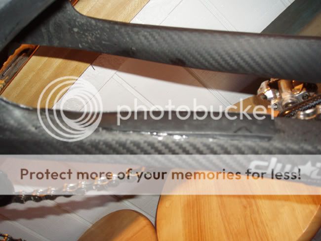

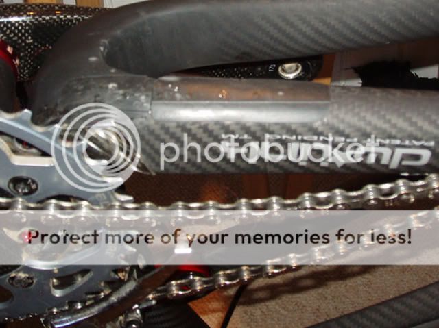

    On anther topic....Check out this picture of some serious chain slap. I bought this bike from a well known shop in Santa Cruz (Another Bike Shop) for a good price, and didn't get a good look at the wear from chain slap until later. I'm sure this demo was ridden hard all over the coast, but this is the only fault I can find. Can chain slap get so bad that the strength of the carbon becomes compromised? I'm getting ready to cover it up tight with an old tube and some electrical tape to prevent any further wear.
    <a href="http://s19.photobucket.com/albums/b152/jnotcher/?action=view&current=Bike021.jpg" target="_blank"><img src="http://i19.photobucket.com/albums/b152/jnotcher/Bike021.jpg" border="0" alt="Photobucket"></a>

    Why is your seat so scooted back??? That looks like an issue for sure, also take a spacer or 2 from underneath the stem, thats another culprit, your bars are almost as high as the seat, thats good for comfort but not really anything else. Put that seat right around the middle of the post and grab a spacer or 2 out from underneath that stem and see how she feels. Basically the front is wandering because all of your weight is back because of the seat being adjusted so far back, and second your bars are pretty high up, both of these things make it very hard to get your weight up over that front tire to keep it from wandering on steep climbs.
    Yeah and for the chain slap, gluing a piece of innertube is what I did before going to a double with chainguide.

    Yes a 70mm stem will feel noticeably different. Here's the solution to chainslap. Cut out pieces of innertube and attach with superglue. Besides protecting the frame it cuts down on noise.
