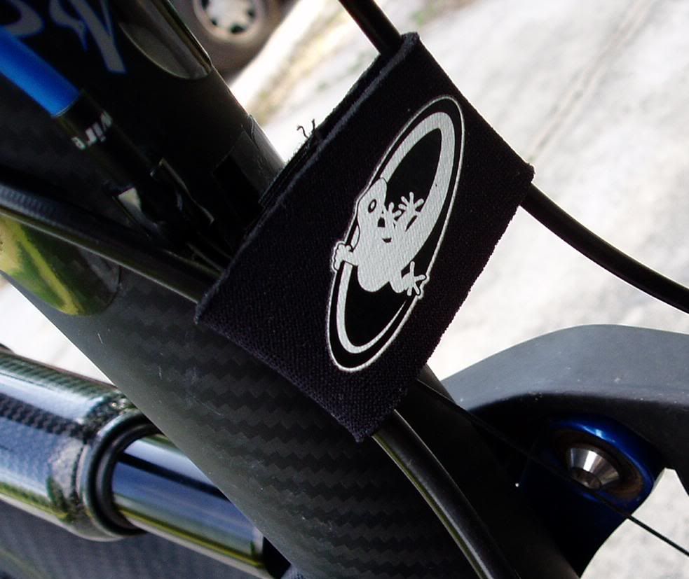

    I've tried various solutions- From the piece of tube that was cut and had the cables routed through from the LBS that built my bike, to a Lizard Skin headset seal, to an old Lizard Skin that was cut and had the velcro sewn in a different location, to zip ties...etc.
    I just ran new cables, and am trying another idea. Currently, the brake cable has conformed to a shape that does not flare out when the suspension compresses. I'm thinking this had to do with how close and how tight the brake and derailleur cable were being held by the head set seal. On the derailleur cable, I'm using one of these. http://www.jensonusa.com/store/produ...ose+Guide.aspx. I have it placed on the seat tube, after the curve of the housing.
    I had my first ride on it today, and did not have any problems out of it. It fits loose enough to allow movement of the derailleur housing during suspension movement. If you're interested, I could post a pic.

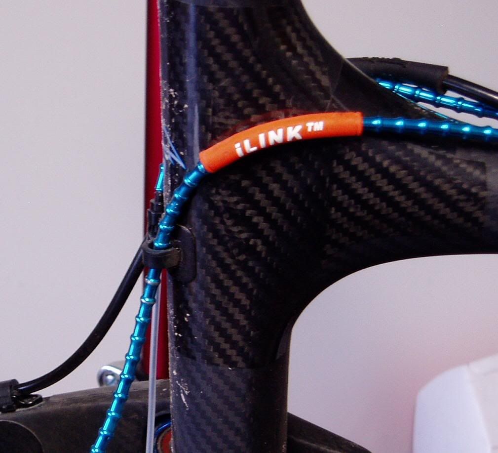

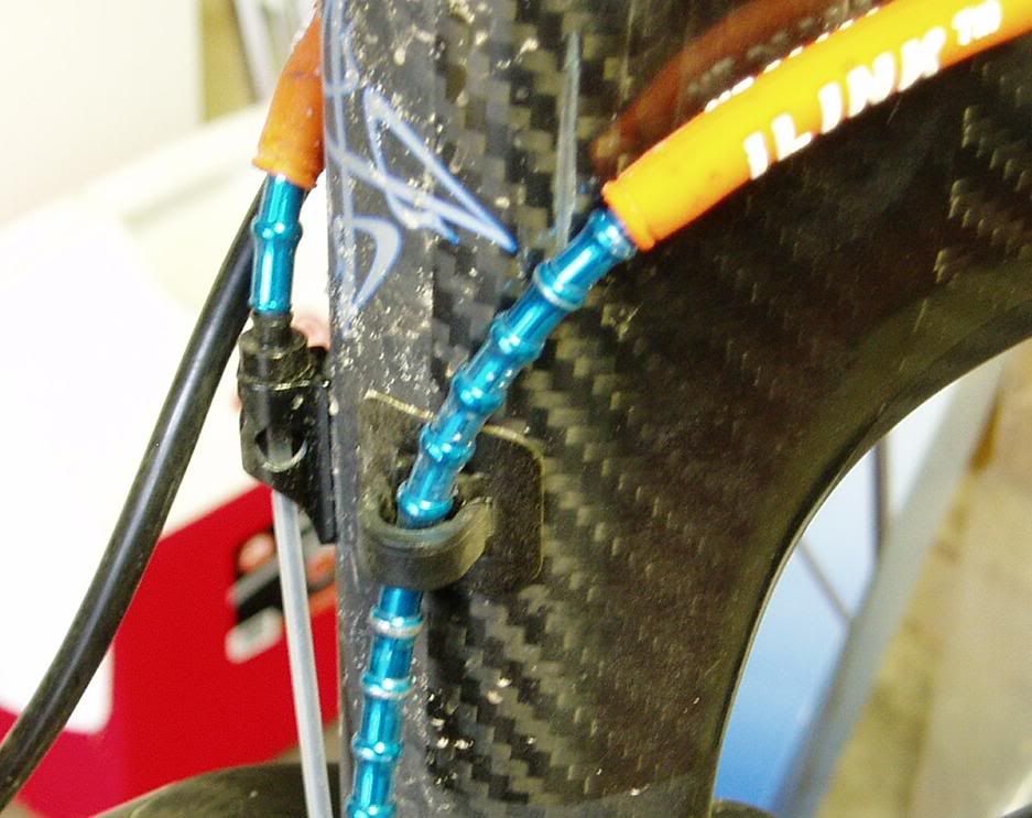

    Here's a pic of a previous solution I was using:
    And this is what I'm currently trying out:
    If this doesn't work out, I'll pick up one of those parts that mtnzj linked to.
