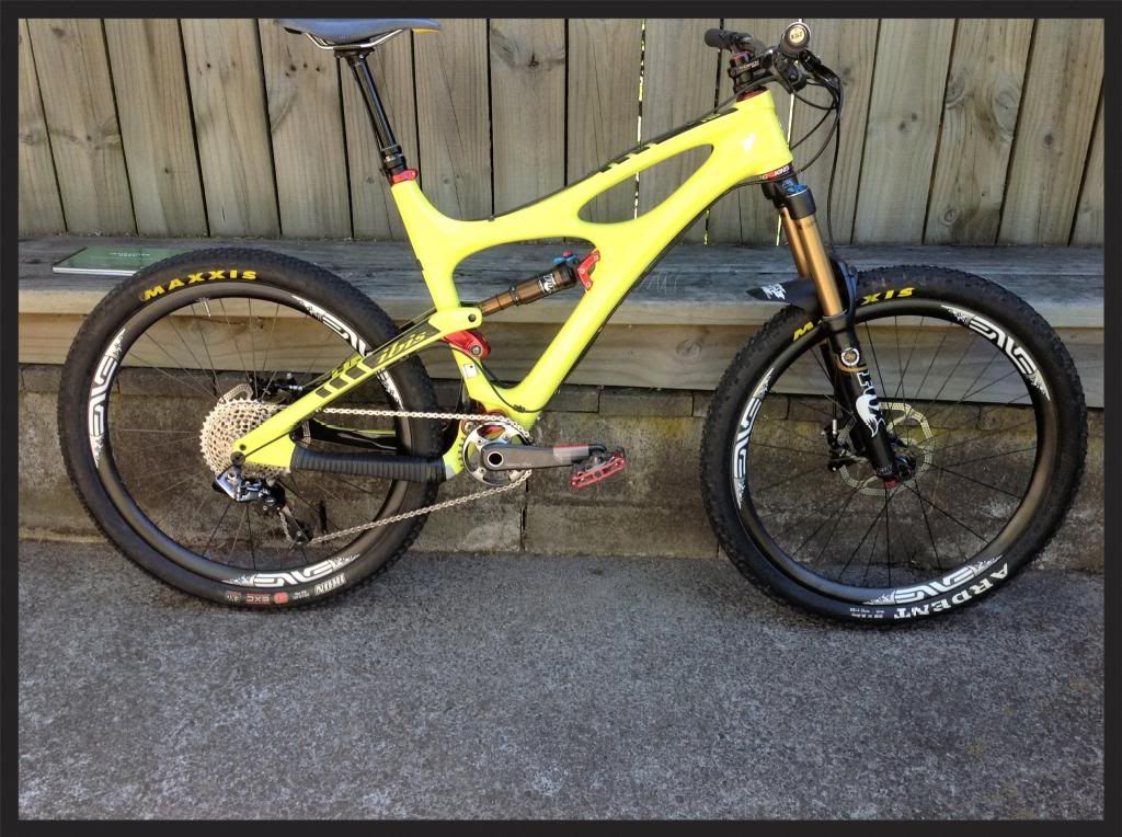

    Hans confirmned my frame is shipping to me today yay, My XX1 has been lonley in its box, I dont get the fasination with losing gears, Ive been on single rings for years, ran 11/36 x 33t up front still rode up everything everyone else did, was it harder yes, but still no issue, with XX1 it will be a doodle, why do people knock what they haven't tried.
    The rear d is heart of XX1 that I find sexy, the cage does not need to go forward and back it just follows each cog, quite amazing, I cant wait to get it on my HD.
    Maybe next week by time it lands goes through customs get her built up, so excited, nit been so excited about a frame and drivetrain for years.
