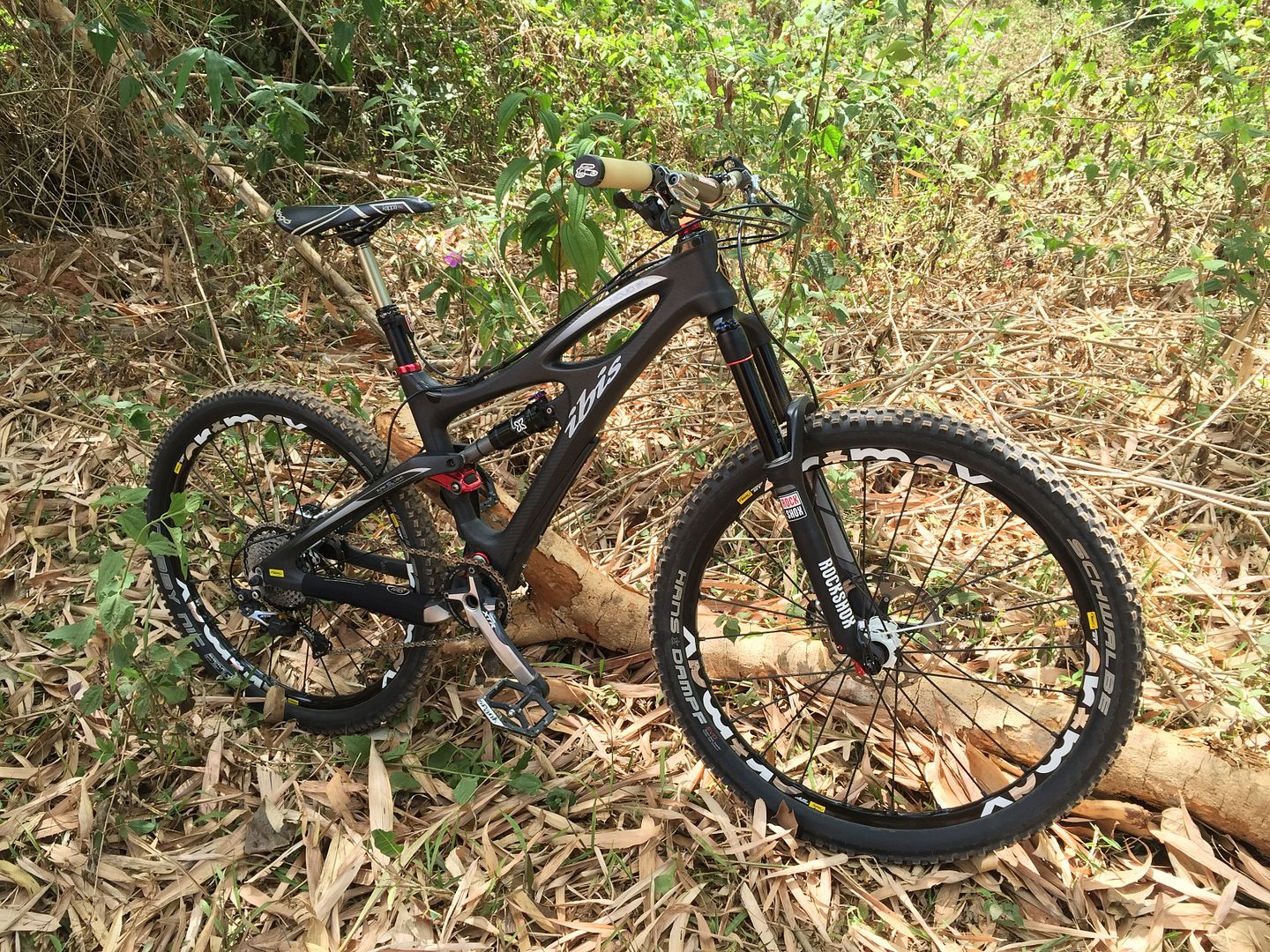

    Old school geometry/drivetrain/wheelsize + some new bits and pieces = still a lot of fun! :thumbsup:

    Is that a renthal bar there GMV? Do you know what you build weighs in at? With dropper post and all?
    Hi lubb1. Yes that is a renthal fatbar lite. Weight is 27.03 lbs.

    What fork is that? Pike? If so, what did you do to use a taper steerer?
  • 10-02-2014
    GMV
    @trap121 it's a 140mm revelation rct3 solo air. Unfortunately, pike only comes in tapered steerer.

  • 07-28-2016
    ClayP
    Originally Posted by Crossmaxx View Post
    Damn, this thread hasn't been posted in for almost one and a half year! Well, here is my Mojo SL, still going very strong:
    Frame: Ibis Mojo SL size M - 2214.2 g
    Shock: DT Swiss XR Carbon - 186.7 g
    Fork: Rock Shox Revelation Solo Air (140 mm, 185.5 mm steer tube) - 1651.4 g
    Headset: Cane Creek IS110 integrated - 93.2 g
    Handlebar: NewUltimate EVO riser bar (700 mm) - 128.0 g
    Grips: ESI Extra Chunky (cut to 100 mm, incl. end caps) - 65.6 g
    Stem: Extralite HyperStem (80 mm, 6) - 69.0 g
    Seatpost: YEP Components Uptimizer ST dropper post (31,6/125 mm drop, incl. remote and cables) - 572.2 g
    Improvised dropper post mud guard: Piece of inner tube - 11.9 g
    Saddle: Tune Speedneedle (front leather worn off) - 95.2 g
    Shifter: Shimano XTR M980 (10sp) with Hope Tech matchmaker - 99.9 g
    Cable set: Shimano SIS SP-41 full length (housing stops on frame drilled out) w. Shimano steel cable - 64.5 g
    Rear Derailleur: Shimano XTR M986 GS - 211.3 g
    Crankset: Shimano XTR M970 (170mm) with Carbon-Ti Titanium 30T (104 BCD) and Wolf Tooth 26-30T bash guard - 612.5 g
    Bottom bracket: Shimano XTR SM-BB93 (without plastic inner sleeve) - 64.7 g
    Cassette: Shimano XT M771 (11-36) - 332.8 g
    Chain: KMC X10SL DLC Black (106 links) - 232.0 g
    Pedals: Xpedo M-Force Ti 8 (including plenty of marine grease) - 218.1 g
    Front brake: Hope Technology Race EVO X2 (plastic hose) - 181.9 g
    Rear brake: Hope Technology Race EVO X2 (plastic hose) - 206.8 g
    Rear brake adapter: Shimano SM-MA90-R160P/S w. bolts - 20.4 g
    Brake disc front: Avid HS1 160 mm - 102.0 g
    Brake disc bolts front: 6 x Hope titanium - 7.2 g
    Brake disc rear: Avid HS1 160 mm - 98.6 g
    Front rim: Edge Composites XC 26" 28h - 350.0 g
    Rim strip: Edge Composites - 18.7 g
    Spokes: 28 x Sapim CX-Ray black (250/252 mm) - 117.3 g
    Nipples: 28 x Proprietary Enve brass nipples - 21.2 g
    Front hub: Carbon-Ti X-Hub SL 28h (15 mm axle) - 108.1 g
    Thru axle: Rock Shox Maxle Stealth - 38.0 g
    Rear rim: Edge Composites XC 26" 28h - 351.0 g
    Rim strip: Edge Composites - 18.5 g
    Spokes: 28 x Sapim CX-Ray black (250/252 mm) - 117.7 g
    Rear hub: Chris King ISO 28h (135x10 mm Thru) - 325.8 g
    Thru bolt: DT Swiss RWS 135x10 mm - 68.4 g
    Front tyre (1): Schwalbe Magic Mary SnakeSkin TrailStar 26x2.35" - 790.0 g
    Rear tyre (1): Schwalbe Hans Dampf SnakeSkin PaceStar 26x2.35" - 741.0 g
    Front tyre (2): Schwalbe Nobby Nic SnakeSkin TrailStar 26x2.35" - 659.0 g
    Rear tyre (2): Schwalbe Nobby Nic SnakeSkin PaceStar 26x2.35" - 652.0 g
    Front tube: Schwalbe EVO Tube 26" - 74.4 g
    Rear tube: Schwalbe EVO Tube 26" - 76.7 g
    Sum with tire (1): 10806 g (23.82 lbs)
    Sum with tire (2): 10586 g (23.34 lbs)
    nice bike! Thanks for listing the complete build spec with weights. Its super helpful!!

  • 01-05-2017
    GMV
    A few upgrades since 2014 -- ditched the 3x10 and converted to 1x10 (OneUp 42t with OneUp RADr)
    Is there any angleset reducer for the Mojo SL?
  • 01-05-2017
    ClayP
    looks nice. Is that 27.5 in front? What fork are you using?
  • 01-05-2017
    GMV
    @clayP thanks! It's still a 26, old crossmax st. Fork is 140mm RS Revelation RCT3 (mission control)
