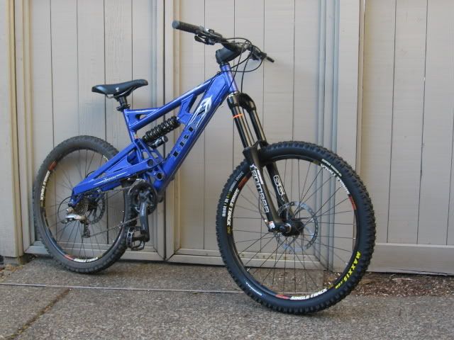

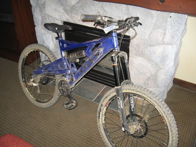

    I did used to run a 170mm 66VF on my zone. I would HIGHLY recommend getting it lowered to 150mm if it isnt there already. With 2005 marzocchi forks, take the actual amount of travel EV 170mm then add 30mm for the obnoxious AC height. so your 170mm 66 will be as long if not a bit longer than a 200mm 888 2006+ what you're trying to pry off is the crown race. if it wont come off easily take it too a bike shop and get it pulled off. while you're there get it pressed onto the new fork.
    This was at 170mm the third pic you can see the 200mm of rake.

    Mine is the 150mm version. I'd like to have 170mm of travel but can't afford a new fork right now and don't want to rake out the bike too much. Should be done with the build this week then I'll post some pictures.

    cool ohh and btw, the 66VF can be raised to 170mm of travel. but like I said, it gets too tall.
