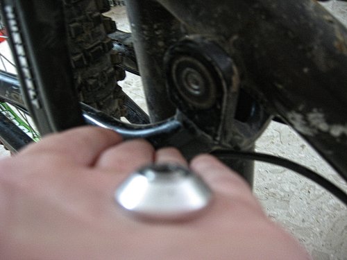

    i went for a quick ride and everytime i brake before turns or just brake in general the rear end became wobbly. so i went back home and the rear end had a really big play. i started to tighten the bolts and after 2 turns one of the bolt ends snapped and now the bolt is stuck inside the frame the bearing cover and the bolt end just fell on the floor
    are there any parts in the frame that could be damaged? if so can i still get warranty? im the original owner but i cant find the certificate from the shop that shows i bought the bike.. but first what to do in general?

    Im not familiar with the pivot arrangement on the X7, sounds like their is two bolts one on each side of the frame. Can you post a picture of the broken bolt inside the frame??

    So it is a long shouldered nut that goes through one bearing through frame then through bearing with a bolt to secure?

    i dont know, i think its 2 bolts with an axle or something one of the bolts snapped so a part of it is stuck in there

    If you have a vise and tools remove the pivot bolt, clamp in vise with towel so you dont damage the surface and dont over tighten or you will create flat spots. See if you can remove the broken piece by grasping with small screwdriver or pics and gently unscrew. Usually when a bolt snaps their is a high spot that is helpful for leverage. Most likely it snapped because it was over tightened so the broken piece is just sitting in their and not seized.
    Whenever tightening shouldered bolts you need to be careful, when the two flats meet bolt to pivot they stop so if you continue to tighten the threaded stud of the bolt snaps off at the head.
    If you dont have tools check with Saber brother is awesome and should be able to help you.

    thats the thing, i havent overtightened it, it was really easy to tight the bolts and it just snapped

    Possibly the bolt was cracked and snapped when you went to check it.

    oh yea i forgot to write it in the forum, the whole pivot spindle was bent and cracked when the guy took it out of the frame, Haro you shouldnt cut corners with freeride bikes
