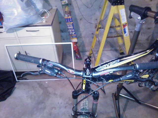

    Guys I just got this frame:
    Now I can't wait to build it! But i'm on a tigt budget so I'm planning to swap all the parts from this avalanche frame:
    Only thing i'd need is a shock. However apparently there's a lack of 7.5x2.0 shocks out there and the ones I've seen are not cheap. I'm looking for a budget shock, just to build it, at least for now, don't care if coil or air. Any of you guys have a spare?

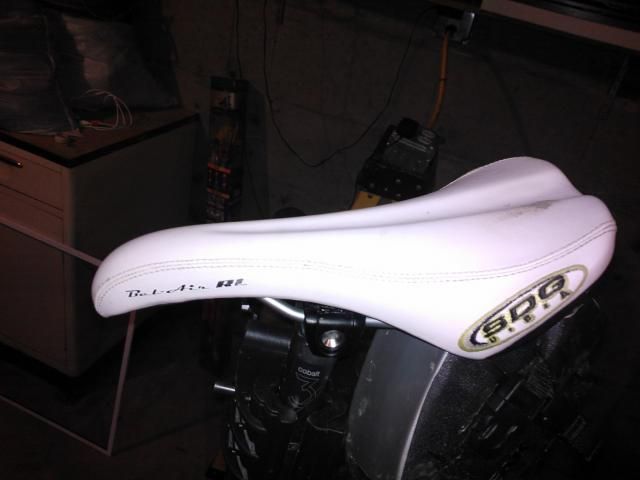

    Ok, today I built up the carbon frame:
    My 2 babies:
