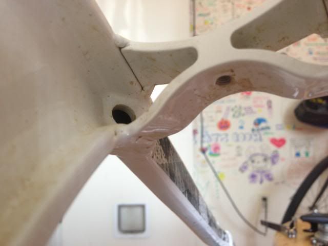

    Had to redo my pivots the other day, and finally did a few mods I had been meaning to do on the Force.
    First up, blocking the vent holes located on the "seat stays" of the rear swing arm. These 2 holes caused dirt and grime to build up in the drop out holes, and that location is notorious for creaking. I basically took some plastic (old tooth floss package), cut it to shape, cleaned out the area with IPA, and then used normal epoxy to affix them over the hole.
    The hole in question:
    The hole in question, covered up:
    Second, mod was to install a shorter shock on the rear to further reduce my BB height and slacken out the bike even more. The offset bushings I have are still on the old shock, and I may add them on this shock in the future. For now the shorter shock really makes the bike super confidence inspiring. I rode Soquel Demostration Forest with the new setup and the bike felt perfect! I thought that with the Workscomponents 1.5 degree headset and the shorter shock that I would suffer climbing, but my fitness was still the only factor.
    I will add a volume reducer to the shock because I bottomed out on a few big drops, but the stock shock bottomed out on the same features also.
    Specs:
    Fox Float R
    Middle Compression Tune
    7.25" Eye to eye
    1.75" Stroke
    Travel is now reduced to 131.25mm or so, but considering I was running the stock shock at close to 40% sag I really did not lose much. It's really super fun.

    I too like most on here had major creaking from my GT Force1.0 alloy bike...
    I thought the whole time it was my BB creaking, that's what it sounds like....
    I read this post and went looking and actually found what I believe to be a design floor in the rear triangle....
    this is how I came up with my fix( please keep in mind this is for the alloy bike-I have no knowledge of the carbons version- guessing it's the same)
    I started by removing the rear dropouts...and this is when I found the flaw in the GT design.... upon removing the pins I noticed they were a little dirty and slightly worn,...worn you might ask?...yeah ..I swore a WTF, mind you my bike is approximately 6 months old since it's build... so I had a closer inspection and noticed a hole in all four dropout bolt holes in the rear of the suspension triangle...and YES, there was sand and grit falling from them into the now vacant holes in the frame...
    I inspected the top of the rear drop tubes and also the front of the chain stay tubes...and the top 2 have rather large holes as the tubes are hollow, and the bottom tubes come around in an arc basically behind the pivots and infront of the leading edge of the rear tire...in the front center of this arc shaped tube you'll notice a small opening, obviously to let the tubes dry out when wet.... well this is where the sand and dirt and grit enter those tubes and make there way down to the rear dropout bolts and allow egress to damage your drop out bolts, I noticed wear on them from the holes.... a simple fix for the creaking is to make sure your tubes are dry and clean and silicon up the holes in both ends, this stops further dirt from getting insid ethe tubes and down to your dropout bolts, then clean and lube (with a water resistant/proof grease) every place metal touches metal where the dropouts meet the rear of the suspension triangle and also all of the pin bolts except the threads and reassemble....my creaking was gone immediately.... sometime after riding (hopefully months or longer) the grease will wash out and wear away and need to be replaced to keep the creaking at bay.....
    Cheers-=CorpSe=-
    hope this helps

    Check out post #712, I even posted some pics waaaay before in case anyone wants to see pics of what your talking about.
