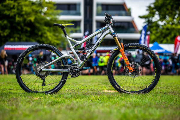

    Sanctions at Sea Otter!!

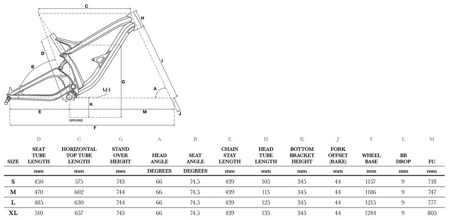

    Does anyone know the reach on the large ? I have one and sent an email to GT requesting the # and they haven't gottin back to me
    Feb 2013
    170
    Geo chart above from vitalmtb.
    Geo table below from Enduro Mountainbike Magazine:
    Size S M L XL
    Wheelbase 1159mm 1188mm 1217mm 1246mm
    Stack 586mm 595mm 604mm 614mm
    Reach 412mm 437mm 462mm 488mm
    Head angle (160mm fork) 66° 66° 66° 66°
    Seat tube angle 74.5° 74.5° 74.5° 74.5°
    BB height 342mm 342mm 342mm 342mm
    Seat tube 440mm 470mm 485mm 510mm
    Horizontal Top Tube 575mm 602mm 630mm 657mm
    Chainstays 439mm 439mm 439mm 439mm
    Standover Height 743mm 744mm 744mm 745mm
    Jan 2015

    Got my GT built up last week, big ride last saturday and ridden everyday before work so far, really impressed with trail riding and climbing actually, there were mixed comments about those, and of course descending is mind blowing, as is flow trails at high speed!

    Nice build!!
    I am thinking to get a Sanction, but is hard to find that model in my country (they don't sell)
    Why did you change che shock? you don't like the Fox X2?

    Hello everyone, has anyone noticed that the Sanction frame geometry has been changed in 2017? Reading 2016 geometry table and then the 2017 one, I've noticed that the top tube length is longer in 2017 (602 mm VS 585 mm 2016 in M Size for example) anyone knows anything about this difference? Is it a different reading? I've never heard about any change from 2015 Sanction frame but maybe someone could tell me something new..
    Nov 2017
  67. #67
    Nov 2017
    I've also noticed that the only difference between those two model year is the top tube length. Every other measures are identical. Is it "physically" possible?
  68. #68

    Have the reach numbers changed?
    Sent from my SM-G955F using Tapatalk
