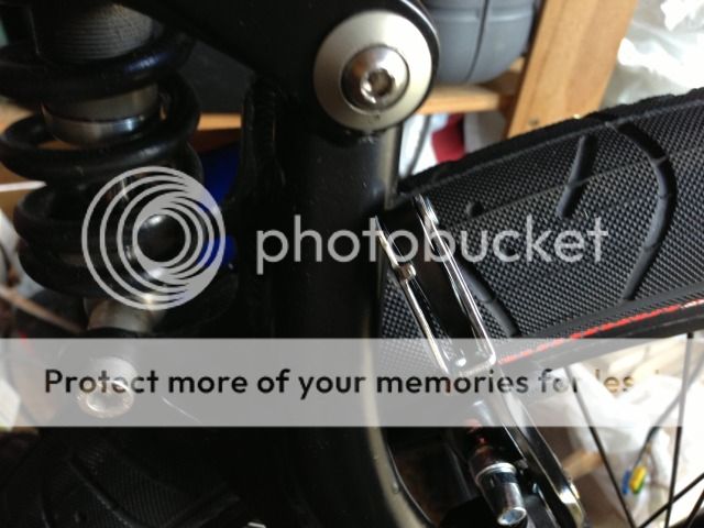

    Hi, Can anyone help. I have what I believe is a GT LTS 2, not sure what year. I am trying to find rear v brakes that will fit. I bought some standard v-brakes but they foul against the seat stay because the levers are too long.
    Can anyone tell me what brakes will fit this bike?
    Many thanks,
    Lee

    Quote Originally Posted by GT_guy View Post
    I know on the first generation of LTS's, when people tried to retrofit V-brakes they found that the longer brake arms hit the stays where they curve up towards the upper link.
    Pretty sure that was the case on all the 94 and 95 frames, so maybe the bike we're discussing has a later rear end or stays. In 96 they spec'd V-brakes and adjusted the angle the bosses were on to allow for more clearance.
    I see I'm not the first to have this problem then!
    So what brakes will fit this frame then, can anyone help?
    Cheers,
