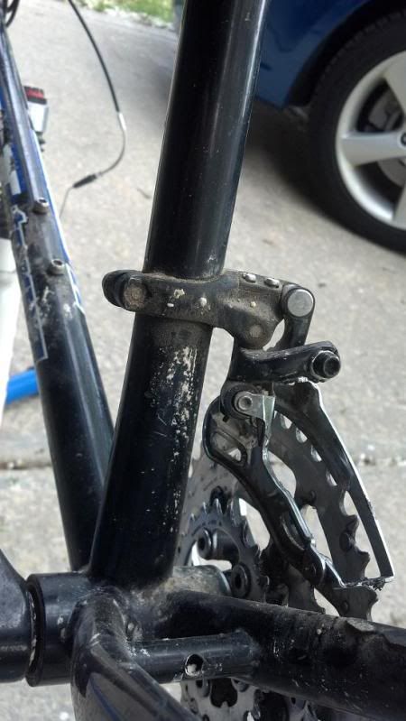

    If you are working on one of these ... this appears to be the correct routing for the front drlr cable. FYI, that small section of tube is not a cable housing, only a plastic tube, and I believe its factory also.
    Also, if you want to convert your old GT from canti brakes to V-brakes, it was very easy with the way that GT ran the cable inside the top tube. You only have to add a housing from the stop at the back end to the brake noodle. To keep the cable movement solid, I put a housing ferrule at the ends of the housings where it runs to / from the top tube.

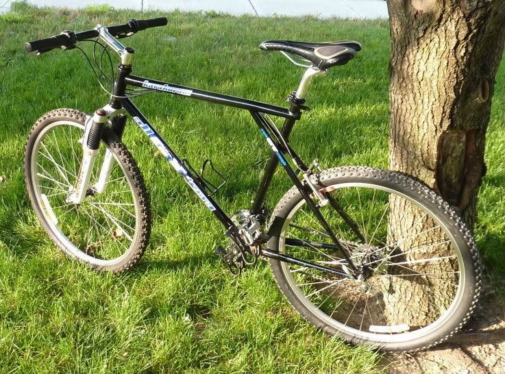

    just finished it up a couple weeks ago and took it off road a couple times ... I had to test it, right?
    I ended up going through almost everything on it and replacing a few things, but its worth it. Its great on singletrack; just sit back and push the ‘bars left-right-left-right. Plus with the triple triangle frame, some (relatively) soft tires and re-worked suspension fork, it feels plush for a hard-tail.
    Its a good classic mountain-bike.

    Thanks, yes, I delivered it last week to my brother. The rebuild was something of a present, ‘cause he likes riding, but has no interest in building. For me the work is a fun hobby [but it did take a lot of time].
