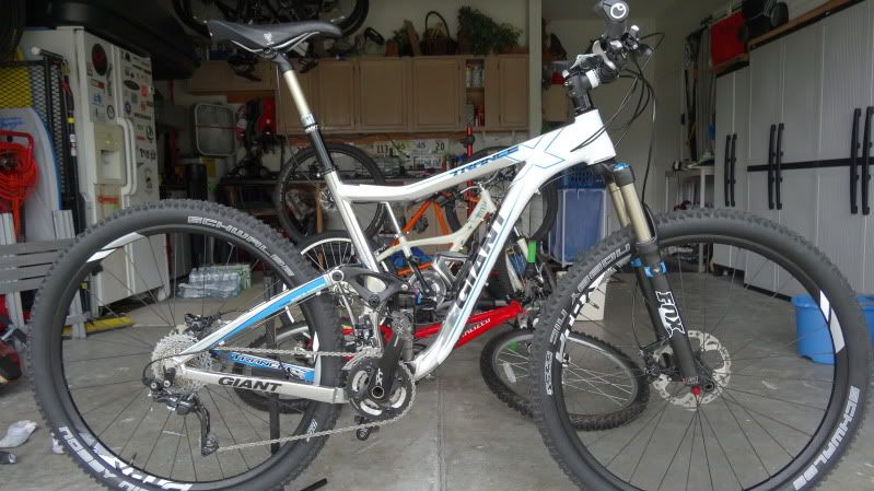

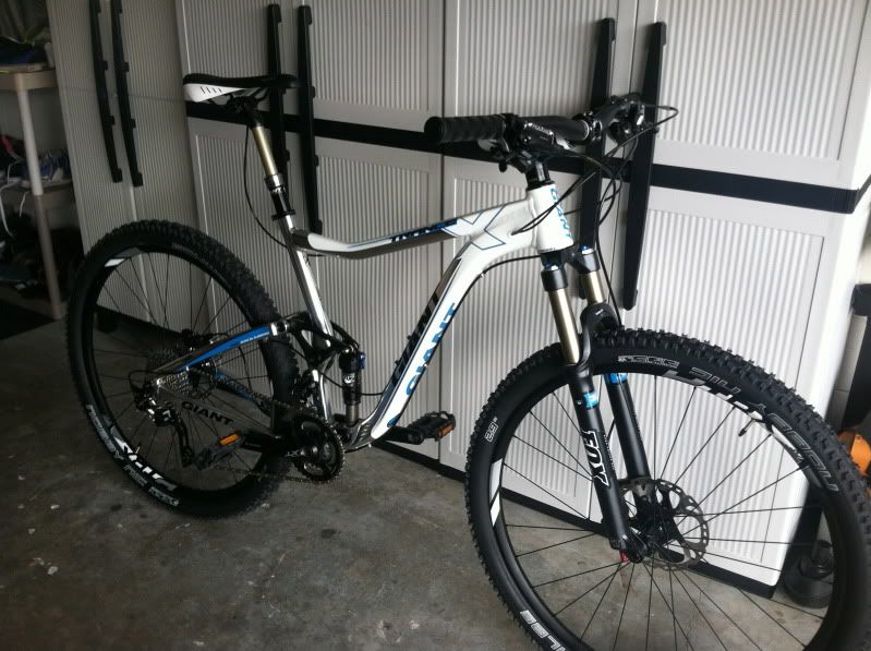

    OK, here goes. Picked it up Thursday, and immediately weighed it. 28 lbs 14 oz. with the plastic pedals. It is a size large. I then put on my Time ATAC pedals and WTB Pure (the heavy one), changed to a more narrow carbon bar, put on some Ergons, swapped the stem to a 70mm, put on my carbon bottle cage, and gps mount. Rode it for 20 miles today, then came home, washed it, and set the wheels up tubeless. Weighed it again. 28 lbs. 14 oz. Was hoping for 28.5, but whatever. Before my ride report, I want to mention that these wheels set up tubeless with the Nobby Nics easier than ANY set of wheels and tires I have ever set up.

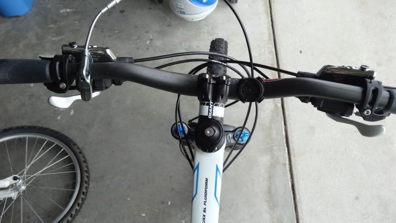

    I had to put more narrow bars and a shorter stem to get comfortable. I took off from the parking lot and thought my sag was set up wrong. Too plush. Stopped to check. Exactly 25%. Started off again, and put it in Climb mode, much more snappy feel. There is a two mile ride out on double track to get to the trails. I then switched back to Trail mode on the fly and felt like it was set up right. I think the initial feeling of a FS bike had me thinking my set up was wrong. I could tell the stem was just a bit too short (will get an 80 on when it comes in). As soon as I pitched it into the first trail I knew I was going to like it. Very tight single track with lots of flow and curves. The bike handled great! I was worried that the front would be too light and wash out, but it never happened. I have run the Nobby Nics before and really like the way they hook up, but they are more tire than I usually run, unless I am up North. The things that stood out:

    Fit-I am still trying to dial in the cockpit. Again, not a big concern, but still a work in progress.

    Stock
    New cockpit
    All changes made and tubeless
