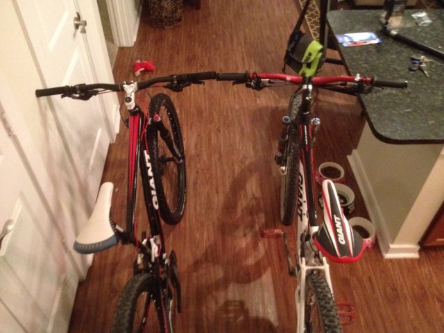

    My large Anthem X 29er next to my medium Trance X 29er.
    Sep 2012
    54
    Can you get a side profile shot of the 2 side by side?

    Nov 2008
    24
    I tried, but it's hard because of the bars and depth of field.
    Sep 2012
    54
    Well think we can all vouch that the TX makes for easier stand over height.
