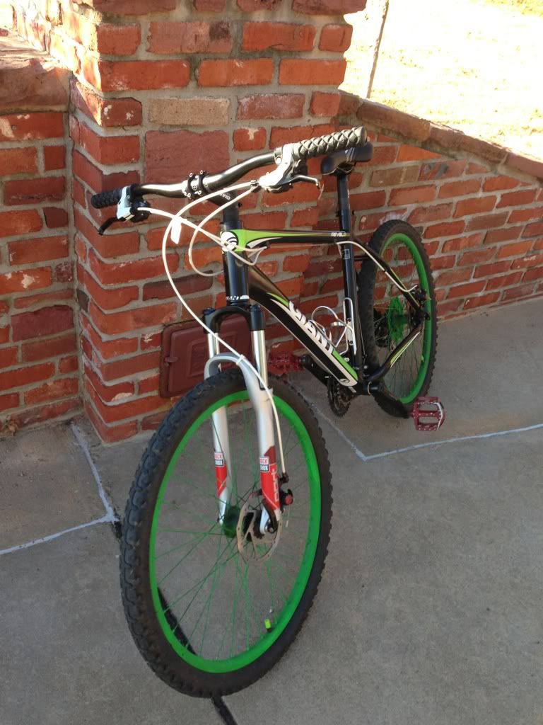

    Here is my 2012 Revel 1. This is just after I added the bashguard. I have since added Ergon grips and Avid Speed Dial Levers. I have ordered a new WTB saddle and am planning to upgrade the fork as many also plan to.
  • 01-11-2013
    coling
    I like that gray and the bash guard looks BA, I'm sure it can handle.

    Thanks. The bash guard is pretty beat up now, so I guess it's doing it's job. Nice pick up on the crank. I'll be interested in how the install goes. I'm a noob so I wasn't aware that the BB was interchangeable with that style.

    Here 'tis
    Finally got my 10 in
    Here's the bike as it looked yesterday
