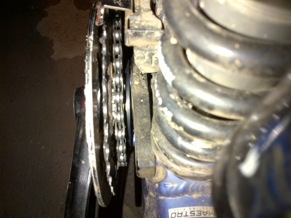

    The Blackspire Stinger ISCG Guide will NOT fir the 2010 Reign X's - not enough clearance for a two-ring setup.
    Here's what happened to my OEM Race Face Atlas Guide (which was awesome, btw):
    Lost the roller, too

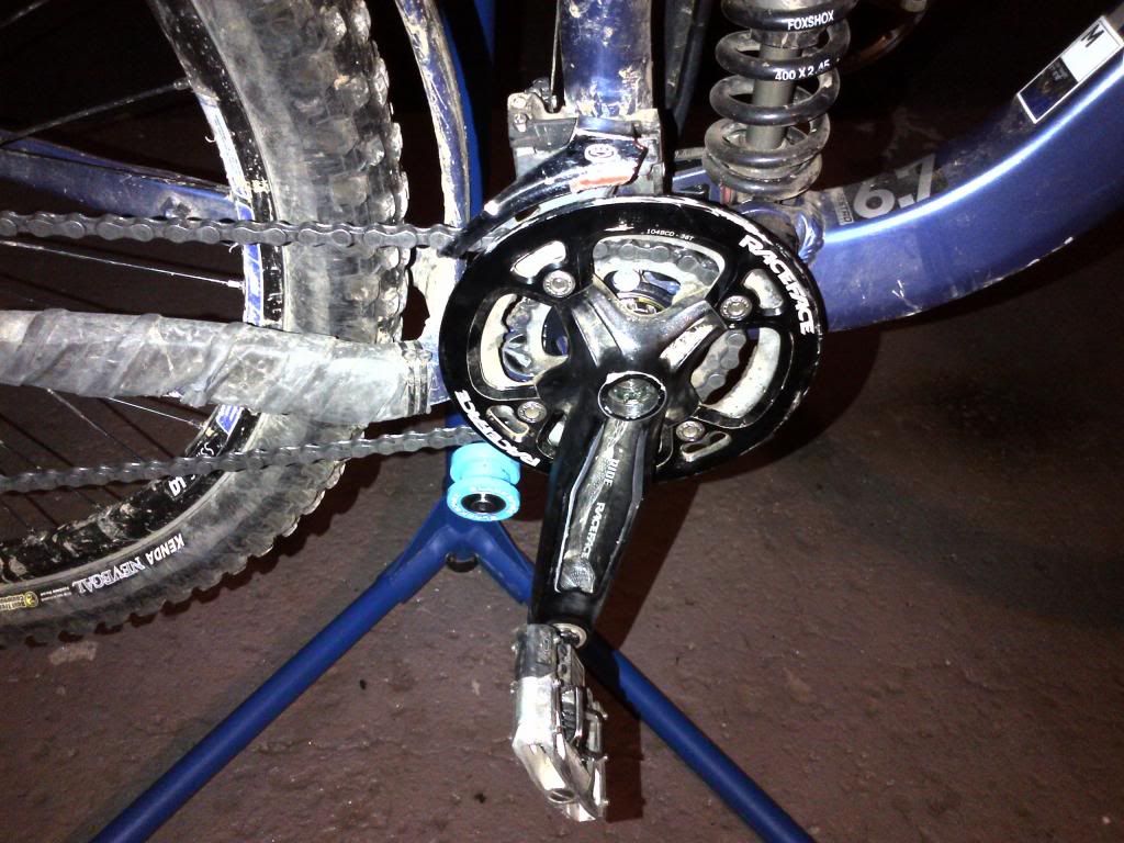

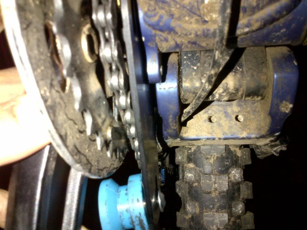

    I replaced the sandwiched unit with a 2.5mm BB spacer, and fitted the Blackspire Stinger - just by measuring the setup, I had a feeling there'd be interference...and assembly confirmed those thoughts. Hard to tell from the pics, but the bish won't even crank.
    Wouldda looked great:
    Anyway, then I got a new idear.... to put the Blackspire roller on the Raceface bracket:
    But since the slot in the bracket is busted, I'm going to explore the option of making a new one myself. Depending on the cost of it, and the lead time, I might go for it, or let NoahColorado hook me up. we'll see.
