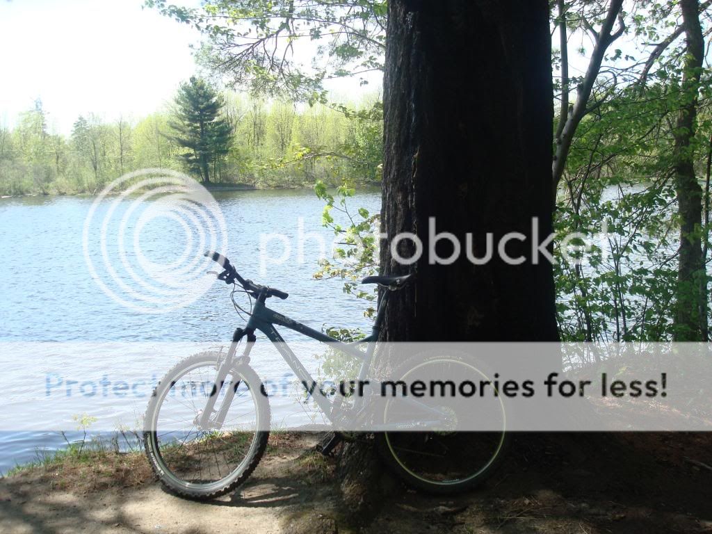

    6 to many sideway pics....I'm dizzy now.
    Regroup and just give me at least 1 full shot of your bike.

    haha sorry about that they were the only ones I had until today. Here's a pic along the river.
    Modified the upgrades and swaps a little bit.
    Currently running michelin XC AT 2.0's until my Conti's come in on Tuesday. Ended up swapping my old wheelset(TerraMax) onto the bike for the extra rim width. Switched back to the stock riser bar but cut it down to about 635mm. XT rear derailleur will go on Tuesday as well. I love the Ergons.

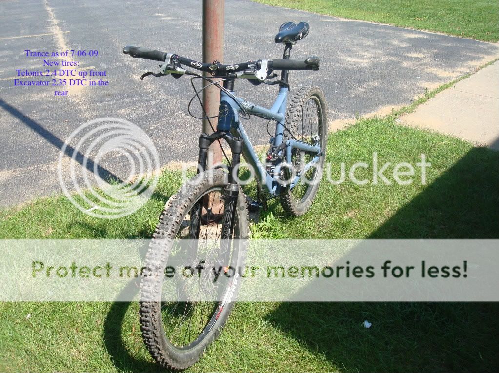

    Update on bike:
    Now running a Kenda Telonix 2.4 dtc on the front and a Kenda Excavator 2.35 dtc on the rear. WOW, WOW, WOW!!!!!!!!!!!! Completely satisfied w/ this combo.
    Considering stripping the paint and having something cusotm done this winter. Might look into a royal blue fade to brushed aluminum or white. Thoughts and opinions?

    New fork will be in by Friday. Will post a new pic after the new forks installed.
    Picture update:
    "The original concept of freeriding was that there was no set course, goals or rules to abide by. "
    Mountain Riders
    Northeastern Rider
    763
    ..........modded both the telonix and excavator. loving it!

    Here is an updated list of the build as of today. Pics to follow when the new wheelset arrives.
    Updated specs:
    Blue = current upgrades
    Red = currently building package
    MODEL: Trance 4 - US
    COLOUR: Slate
    FORK: Marzocchi XC600 TST2 140mm
    SHOCK: Fox Float R(240gr)
    WHEELS:
    FRONT HUB: Shimano XT m775 CL
    REAR HUB: Shimano XT m775 CL
    SPOKES: DT Swiss Comp DB 2.0/1.8 silver w/ Brass pro-lock nipples
    RIMS: Mavic XM719 silver
    F TIRE: Modded Kenda Telonix 2.4 dtc - Tubed for now
    R TIRE: WTB Prowler XT 2.3 - Ghetto Tubeless
    SKEWERS: American Classic QR
    STEM: Easton 105mm x 6
    BAR: Easton riser Cut 1" off each end(-20gr)
    POST: Easton
    GRIPS: Ergon Race L w/ Magnesium bar ends
    SADDLE: WTB Rocket V(300gr)
    HEADSET: Cane Creek Integrated
    F BRAKE: Shimano XT m765
    R BRAKE: Shimano XT m765
    ROTORS: Shimano CL 203 front, 160 rear
    LEVERS: Shimano XT m756
    CRANKSET: Truvativ FireX 22/32 w/ BBG Bash Guard
    PEDALS: Stock Plats and WTB mp250 - 260gr.
    CHAIN: Shimano w/ Sram gold connector
    FREEWHEEL: Sram stock
    F DERAILLEUR: Shimano Deore LX(177gr)
    R DERAILLEUR: Shimano Deore XT m760 long cage
    F SHIFTER: Removed
    R SHIFTER: Shimano Deore
    OTHER: n/a
    WEIGHT: around 32-33 or so
    ADDITIONAL INFO (Any Extra comments / accessories):
    Rider: 240lbs, male
    Mostly aggressive XC / light AM and some Freeriding, 2-3' drops max, lots of rock climbing
    UPGRADES TO COME SOON:
    lighter bar, seatpost & 90mm stem.

    Got the new wheels in yesterday. Going w/ silver hubs, spokes and rims w/ black nips sure was a good way to go. Looks very sharp on the blue. The 8" rotor up front looks great also.
    I couldn't have realized how much my other rear hub was dragging until putting the new wheels on. Unbelievable. CRC's build quality is excellent as well.
    Mountain Riders
    Northeastern Rider
    763
    Just put a new WTB Prowler XT on the rear, ghetto tubeless. Rolls super nice and feels pretty heavy duty. With any luck it'll grab really good too.
    My fork is on its way back from Marzocchi also so I should have it mounted by weds or thursday this week. Can't wait to slack the bike a bit.
