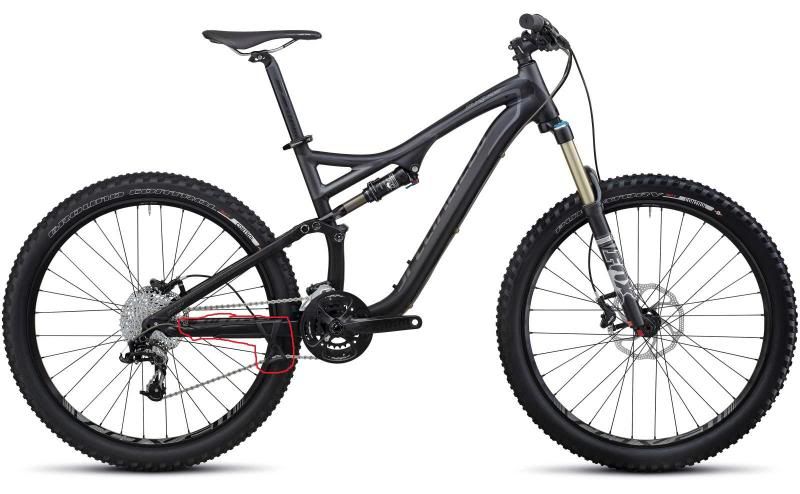

    Same thing was happening to me. The chain would actually come off the big ring, if I go through some super rough terrain. I haven't tested it out yet, but I may have found an affordable solution. I used the chain stay guide and protector from a Specialized Stumpjumper. It fits the bike fairly well and is $30. I put it on yesterday, but won't get a chance to ride until tonight.

    I bought it from Rock N' Road Cyclery in Mission Viejo, CA. You can talk to Paul there. Not sure if they ship or not. Tell them Khoi sent you. The item description on my receipt says, "2012 SJ FSR Alloy 26" CS Prote $30.00". I'll try to snap a pic of it on my bike tonight. I was considering the Bionicon C Guide, but this is $20 cheaper and protects the chain stay.

    Update: rode with the Specialized piece today. Noticeably less noise from chain slap. Didn't lose the chain at all, but the trail today wasn't the best for testing that. I usually lose it and rough DH sections. It came off 3-4 times on Saturday at the bike park without the new guide. Shifting seems to be normal. It shifts into all the gears just fine. It's early but I feel like this will solve my issues.

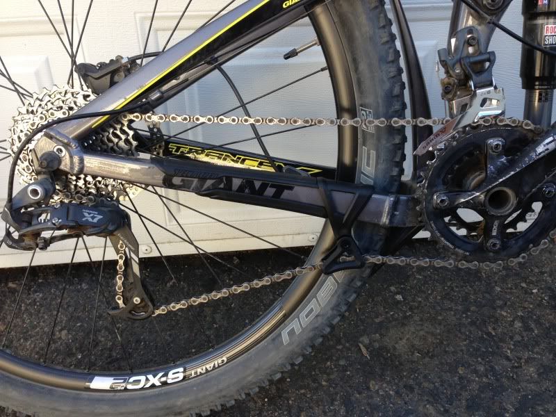

    DIY Guide
    Guys,
    Cost 10c and 10 minutes.
    Needs Help: Chain Guide-dsc_9706.jpg
    Aug 2013
    34
    Lol, that is clever. Albeit a little ghetto. Nice work! How long do the cable ties last that feed through the guide tube?

    Nov 2012
    33
    Guys,
    Bottom piece cross section of Artline 660 Highlighter | Tiger Pens
    Top piece is just outer core of electrical cable.
    I think it will last a year or more, as one can flip guide tube around 4 sides to wear off.....
    Just tested it today. Added to my XTR RD Shadow Plus, it totally eliminated all chain slap noise. Doesn't rattle like Shakira anymore.
    Chain still dropped on a very bumpy trial on highest gears 11T or 13T. I'm not totally convinced this Bionicon concept works for this, as it works poorly to minimise lateral (sideways) vibration of chain, the biggest contributor to chain drop.
    Anyway its only 50 cents to tryout, so guys, give it a shot and feedback here......
