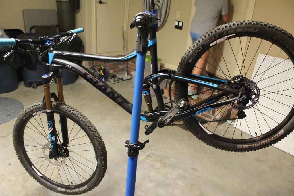

    some pictures of the Trance SX (Update: Ok this pictures are ****. I've got the bike now and added some better pictures on page 5 of this thread. I should have made better ones in the first place but testriding was so exciting)
    Giant Trance SX 2015 (vs. Reign 2015)-20140928_103806-1024x768-.jpgGiant Trance SX 2015 (vs. Reign 2015)-20140928_103822-1024x768-.jpgGiant Trance SX 2015 (vs. Reign 2015)-20140928_110639-1024x768-.jpgGiant Trance SX 2015 (vs. Reign 2015)-20140928_110646-1024x768-.jpg
    Weight Trance SX bike and wheelset (read more about why I kept them on page 5)
    Giant Trance SX 2015 (vs. Reign 2015)-20140926_171643-1024x768-.jpgGiant Trance SX 2015 (vs. Reign 2015)-20140926_171800-1024x768-.jpgGiant Trance SX 2015 (vs. Reign 2015)-20140928_113605-1024x768-.jpg
    Weight Reign 1 bike and wheelset
    Giant Trance SX 2015 (vs. Reign 2015)-20140927_090253-1024x768-.jpgGiant Trance SX 2015 (vs. Reign 2015)-20140927_090507-1024x768-.jpgGiant Trance SX 2015 (vs. Reign 2015)-20140927_090746-1024x768-.jpg
