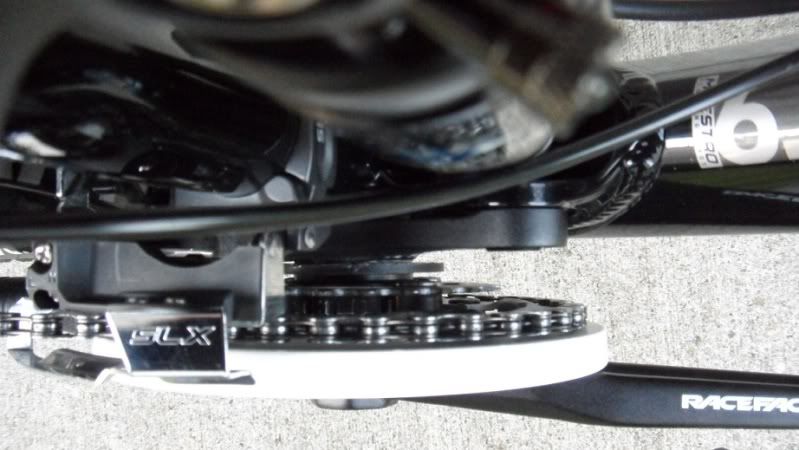

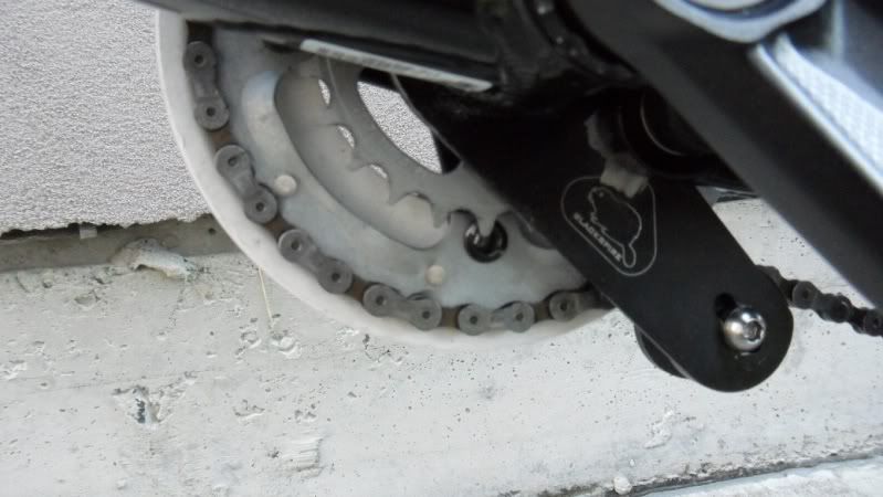

  • 06-10-2010
    twistedshifter
    09 Reign 1
    Here is my set up.
    Stock 09 Reign 1 size L
    Mods so far:
    Thomson 70mm 0 rise stem
    Sunline V one 745mm (cut to 730mm) bars
    Atomlab Pimp Sealed pedals
    Chromag Trailmaster DT saddle
    Ergon GA-1 grips
    Recently dropped the big ring and running an E13 DRS Bash/chain guide
    Had to cut down stock seatpost 3" to get the seat to drop more
    Attachment 548932

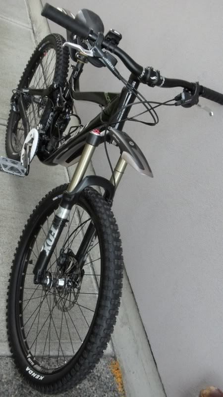

  • 06-20-2010
    Jose86
    3 Attachment(s)
    09' Giant Reign 1
    I've made a few changes from stock setup.
    -Fox 36 Talas RC2 (2010') (this is the most important upgrade, which really widens the bike's potential)
    -Fox DHX AIR 4.0 (2.25 stroke, and a small volume air can)
    -Truvativ AKA stem 60mm (stock was too short)
    -Mavic Crossline wheelset (more of a AM wheelset, and I needed something with a 20mm thru-axle)
    -200mm rotors (f+r), which came with the wheelset, and I weigh nearly 95 kgs with gear, so the standard rotors weren't giving enough stopping power.
    -Maxxis ardent 2.4 f+r
    Benefits from upgrades:
    -Slacker head-angle/more travel makes the bike a lot more capable on the descents. The travel adjust is a necessity, however, as I use it all the time for climbing and general riding. If you're going to get 160mm forks, get a travel adjust one for sure. It also makes it more stable at speed, with the longer wheelbase. The stock forks are ok for general trail use, but if you want to hit downhill specific runs, you'll want a bigger fork
    -The new shock rarley bottoms (more progressive from the small air can), which was a real problem on the stock Rp2 XV shock. It seems to use the travel better, with more mid-stroke support, and feels significantly smoother. The new shock also gave the Reign 170 mm travel, which once again, gives a smoother ride on downhill specific runs (I do lifted runs with it as well as general AM riding).
    -Wheels are stronger/laterally stiff, but are about 300 grams heavier. The tyres are a lot heavier, but are good for the downs (bad for climbing though, but I mainly climb for fitness so it's OK, kind-of).
    This bike was pretty awesome to begin with, but, the upgrades I've made have really turned this bike into a real 'all-mountain' bike, which can still climb, but absolutely rips on the descents. It's not as smooth as a dedicated down-hill bike, but, it's about 80% there, compared to around 50%.

  • 07-27-2010
    sgf2
    Here's another one - 2009 Reign 0.
    Upgrades:
    2010 Fox 36 Talas
    CrankBros 4in Adjustable seatpost (Can't live without this thing)
    Wider Bars
    Shorter Stem
    ODI Grips
    XT Pedals
    WTB Rocket V Seat
    Race Face Bash Guard
    Better Kenda's, i flatted the stock's more than any tire i've ever owned.
    Attachment 558568
  • 07-27-2010
    twistedshifter
    Nice one. Is that an XL frame? It looks huge for some reason. What wheelset is that?
  • 07-27-2010
    murrdogg11

  • 07-27-2010
    sgf2
    XL and it looks even bigger in person, if you don't have 9 3/4 of steer, you cant fit the fork. Biggest dang bike i've ever owned. The L was just a little too small for me.
    I've got a mismatched wheel set, the rear is the stock WTB, the front is from my buddies Trek Remedy. He won a new wheel set in a raffle and graciously sold me the 1 year old front. So its a Bontrager Rhythm, I'm thinking of making it tubeless.

    I am new here and new to mnt biking in general. This is my first bike and with only 2 rides, I can say I made a pretty good choice.
    2008 Reign 0 size small
    2010 RS Revelation Race 150 20maxle
    2011 Fox RP23
    Mavic Crossmax XL (overkill for me, want lighter wheels)
    Trail King UST (way too heavy but work good)
    Sunline V1 AM 50mm stem
    Giant contact riser bar 690mm
    Giant contact seatpost
    Selle An-atomica titanico saddle
    XT cranks 175mm (wish they were 170!)
    XTR 11-34 cass and chain
    Brakes and drivetrain stock
    Wellgo ti pedals
    Alligator Wind Cutter rotors
    Oury grips
    26.4 lbs as in the pic
    Brenda
    Updated pic and new cables, pedals, tires, rotors.
