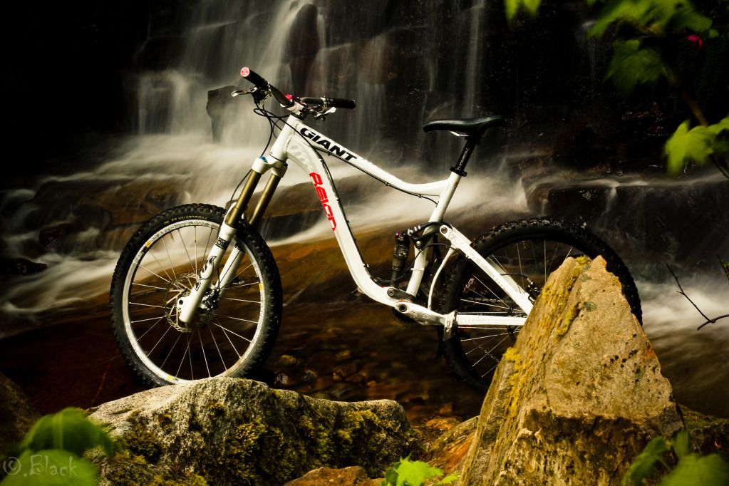

  32. #432
    Mar 2014
    Hi everyone!
    Here is my Reign 2, 2013 with some modifications:
    - Rock Shox Lyrik RC2 DH, 170mm travel
    - Shimano SLX brakes, 180/180 rotors
    - FUNN FatBoy (760mm) and Funnduro (30mm)
    - Leonardi Factory General Lee wide ratio cassette adapter
    - Blackspire wide narrow chainring (32T)
    - Shimano Saint pedals
    - Selle Italia seat
    - Maxxis minion tyres
  33. #433
    Sep 2013
    392
    Great bike. Are you happy with the Lyrik? Is it air or coil? I am thinking to buy one for my Reign as well.

    Mar 2014
    Quote Originally Posted by Paris Galanis View Post
    I'm very happy with the Lyrik. It's an air fork. Some people say coil is better, but I haven't ride it yet. Overall it's a great fork for that money, especially if you're buying an used one.
