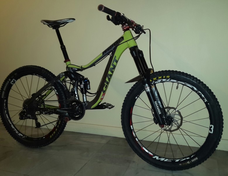

    Anyone have asymmetric seatstay on their Reign 2013?
    Mine is approximately wider on the driveside. difference around extra 0.125cm on driveside
    My rear wheel fitted with HR2 2.4 on Red Metal 3. I can see the non-driveside seatstay has some marking just some lines, no deep scratch, when the wheels is warped.
    Haven't test it out since I sent it for a true.
    I have the blue frame 2013 Reign. The seat stays look to be the same size on my bike but I do have rub marks on both seat stays. I have a an Ardent 2.4 on the back on the stock rim. Whats the HR2 like on the back, I thought they were more suited to the front. I'm thinking about tubeless a set up for the rear and I have a near new HR2 2.3 that's tubeless ready. Anyone know if the stock DT Swiss wheels be run tubeless?

    50
    my updated reign 13.
    hodor.

  91. #691
    Dec 2013
    14
    Quote Originally Posted by chyu89 View Post
    It doesn't change the geo, it only use up the extra space at the swing arm. But note that the sag must be set based on the original 200x50. Means if on 200x57. You need to set the sag to 20% to get the actual 25% sag.
    171mm to be exact
    I did it on my Reign 2011, putting a monarch plus 200x57, a marzocchi 55ti 170mm on the front, and from an entry level trail bike it become a beast
