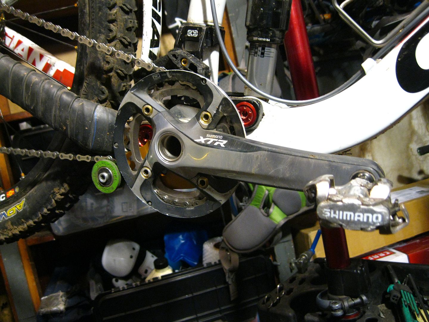

    Agreed. Installed one today on my 2010 Reign. Only did a test ride around the neighborhood but it seems to work great.
    Take a look. I am running a 2 x 9 drivetrain and had previously removed a link. In the picture I have it in 1st gear on the back (34) and 2nd ring on the front (32), so the tension is as tight as it should get. I did cycle the suspension to verify enough room left on the chain to compensate for the suspension movement.
    Will be able to give it a go tomorrow.

    scrublover - the bottom bracket mounted Stinger could work on my 2010 Reign but the 2011 and newer have the press fit bb and from what I have read they will not work.
    The reason I went with the C-Guide over the Stinger is more to control the chain slap rather than chain retention. The stinger being located so close to the crank will definitely reduce or eliminate dropping the chain off the crank on single or dual ring setups. I have run both the E13 DRS and Stingers on my FR bikes and have been quite happy them.
    On my Reign I believe the Stinger would have helped with the chain drops but would not have done too much in terms of chain slap. The location where the C-Guide gets installed is close to the rear derailleur so it should do a better job of limiting chain movement over the rough chop.
    One problem I had that showed up on two rides in a row occurred when running in 1st gear on the cassette while hitting bumps or smaller jumps. Even though my rear derailleur is setup correctly (top out and b-screw limiter), I would loose the chain over the back edge of the cassette into the wheel. Luckily no harm was down as I was able to stop immediately and fix it. After removing one link from the chain, on the one ride I had it was successful with no chain into spokes, but the chain slap was still quite prevalent.
    So tonight, I will ride for the first time with the C-Guide and be able to report back on how helpful it is.

    Right, but Rideit is talking about another bike with a press fit BB, so BB mount won't work either. The C-guide could work, but if he wants something closer to a full guide, using something mounted off and ISCG adapter that clamps around the BB shell would work better.
    Preferably not a guide with a taco though, as all the force from nailing the bash could very easily make the whole guide setup rotate or mess up the frame.
