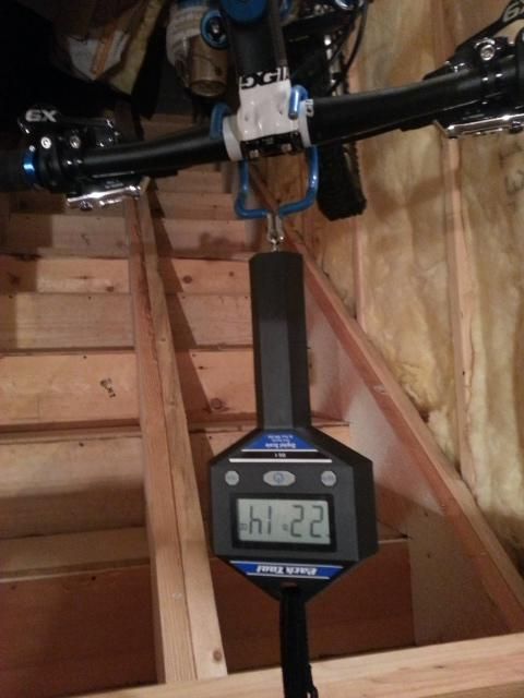

  10. #310
    722
    I had a 1x10 setup on my Anthem previously, but before the narrow/wide chainring thing came along so I had to run an MRP guide that I had to space out to work with the Shimano chainline. I found the 34t chainring to be ideal for my riding, so much so that going back to a 38/26 combo felt awkward at first as I was rarely in the middle of the cassette with range either direction like I was with the 34. Went back because my guide broke. Anyway, got my Raceface narrow/wide and XT Shadow+ waiting for me at the shop for when I get back from a work trip. It's also good for some weight savings, a fair bit actually.
    In fact, now that I have my Mavic SLR's on, my X1 size medium is surprisingly svelte. The only other thing I've got that's not stock is an Easton carbon bar. Current weight is 26.1. Measured several times. I expect, with the weight I've saved before going to 1x, that when I do go back it'll get me between 25.2-25.4. Not bad for a full suspension aluminum 29er.
