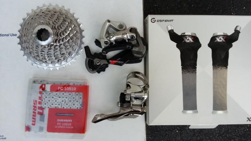

    I wanted to run Sram XX grip-shift, and found good deals from various suppliers to piece the group together.

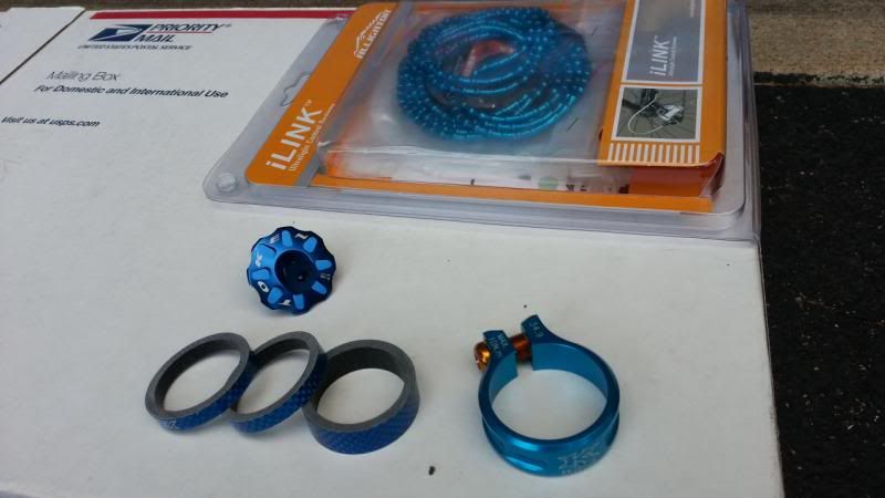

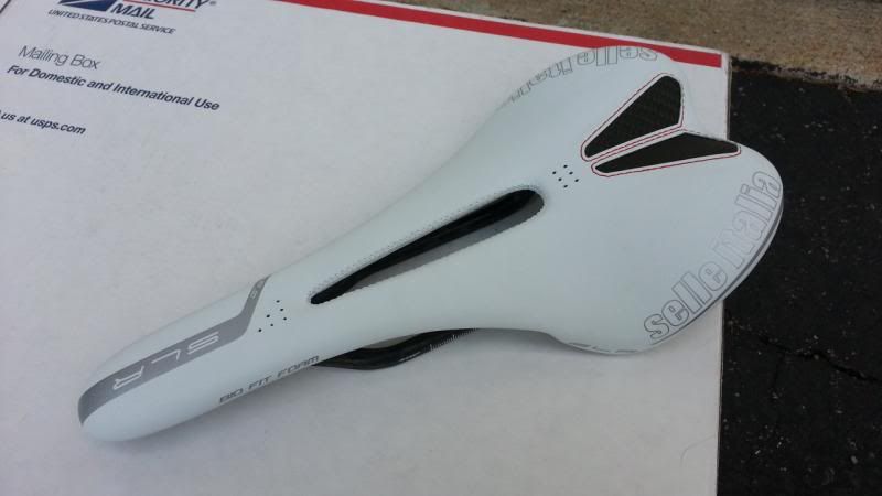

    I selected some weight weenie bling to add to the collection of parts.

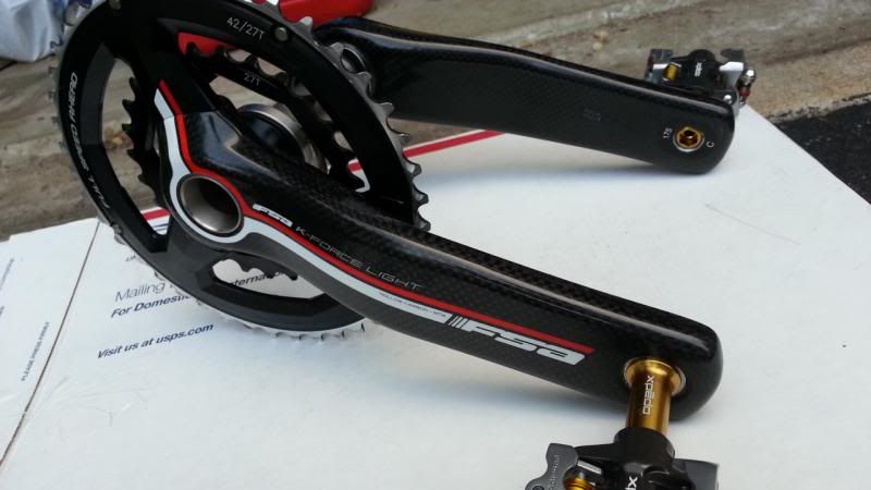

    An FSA 386 carbon crankset, and Expedo Ti pedals.

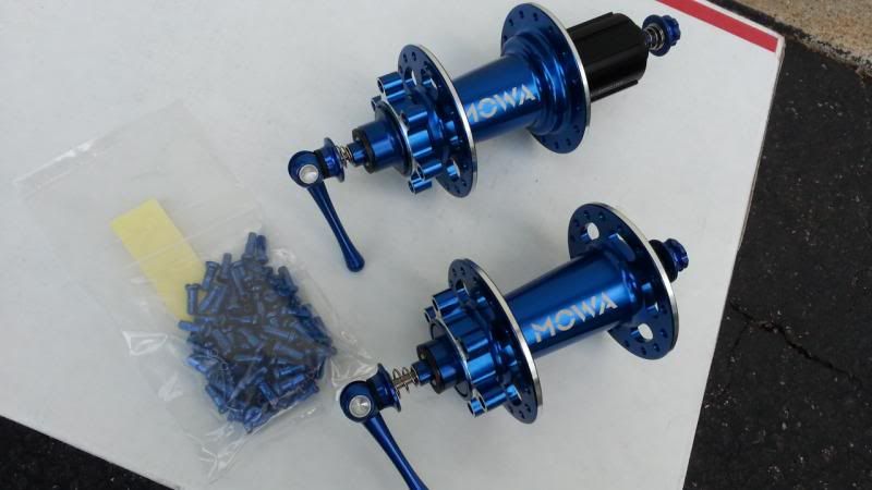

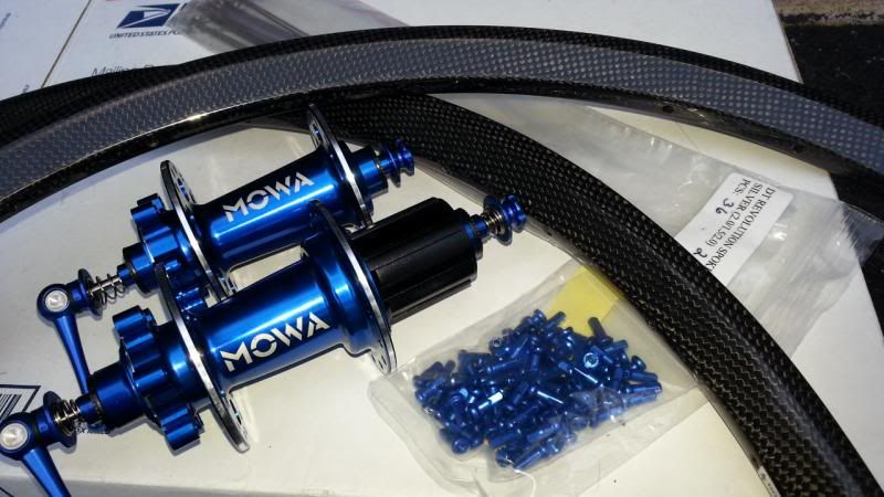

    I found these superlight Mowa hubs on ebay, and thought I'd give em a try.

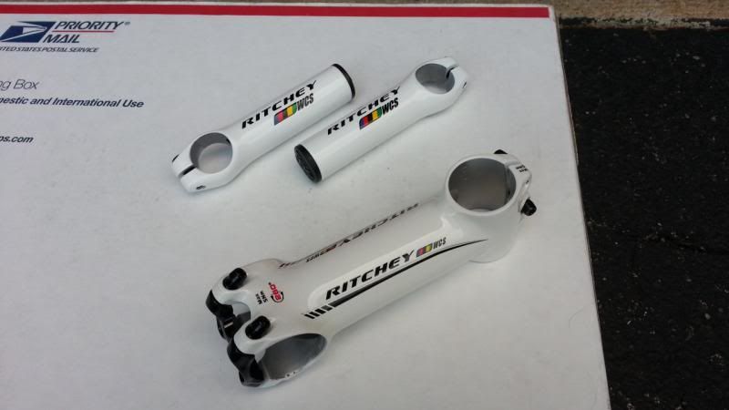

    Hygia SLP hydro brakes, alloy and ti bolts, Some Ritchey cockpit components, and I scored an awesome deal on this Selle Italia carbon rail saddle that really fits my tush well.

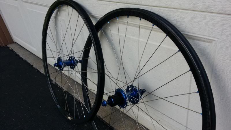

    Got the wheels assembled, but not trued up yet. They are superlight!
    I'm using DT revolution spokes/alloy nipples. Also going to have J&L Ti skewers.

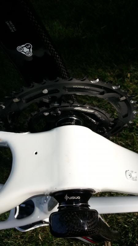

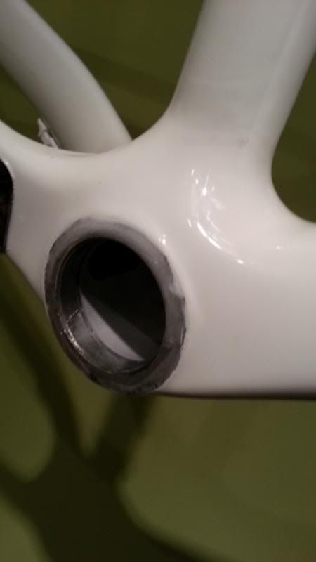

    The frame has a BB30 bottom bracket. I'm not a fan, but it certainly is light. (I just don't like the way a BB30 is engineered.)
    The painter didn't do a good job of masking it off, so I had to clean it up before getting the BB installed.
    I should warn anyone considering tackling a custom build for the first time, that this is something I have plenty of experience with, and you might hit a lot of stumbling blocks along the way. For example, I got a great deal on the fork, (50% off) but it needed an adapter shim to fit the tapered headset. I just made one, and pressed it on myself. Also, I used a dial caliper to measure the BB before installing it, to get the correct fit, and I carefully pressed the bearings in place.
    I also scored an awesome deal on this brand new carbon crankset, but it was made for a standard English threaded BB, so I got this conversion BB from Origin8, that properly fit, and everything was good to go, and also saved a little weight.

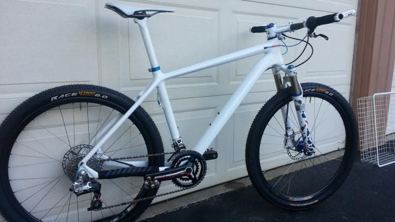

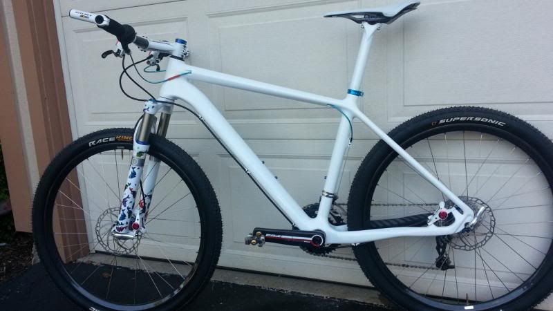

    Got it all built!
    It turned out very nice! Rides great, the BB area is super rigid, and the shifting is the best I've ever experienced.
    I had to use my everyday wheels to get it rolling. I have issues with my tire and rim choices. Apparently these rims don't have a deep center area for the bead to rest in while mounting the tire, so I couldn't get the Conti tires mounted. I also don't run tubeless, so my rim tape was also taking up some room in the center channel. I have yet to resolve that, and may have to run these rims tubeless.

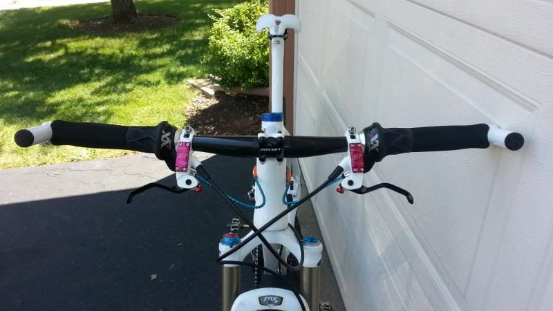

    I took my new ride out for its maiden voyage on Saturday, and it made a few things apparent. My previous ride was a 16" frame, and I wanted the longer TT of the 18", so that's what I ordered. My old fork was also a Fox F32, but it was an 80mm travel version. This frame has a taller headtube, and combined with the 100mm fork travel, I couldn't get the bars low enough for my preference. I have my Ritchey stem flipped at -6 degrees, and no spacers under it, and it's still about 2" higher than I'd like.

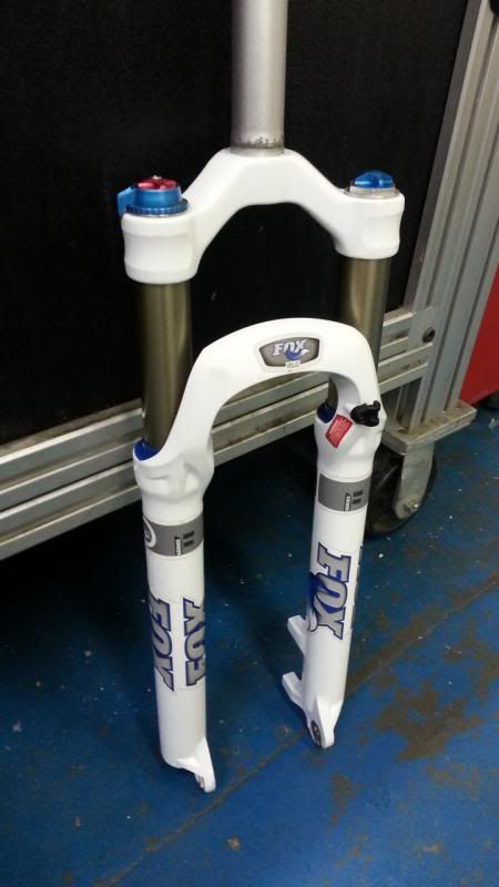

    Does anyone here know if I can lower the fork, by shortening the travel back to 80mm?
    I think if I can do that combined with a -10 degree stem, I could get it to sit a little closer to my liking.

    Finally got my tires mounted on the rims, by changing the rim tape to a thinner brand, and saved a tiny bit of weight too. The bike is right around 18 lbs even, with this configuration.
    I can't say whether or not I like the smaller version of the Race King tires. Need to try them out on real trails, and not just the local crushed limestone paths around here. They are remarkably light tires, but some people clain they have nowhere near the same excellent qualities as the Race King 2.2 versions.
    I also replaced the "too light for real world use" J&L skewers, with some Salsa ti skewers, and saw an instant improvement.
    Now I need to lower my fork down to 80mm travel and see how the bike fits.

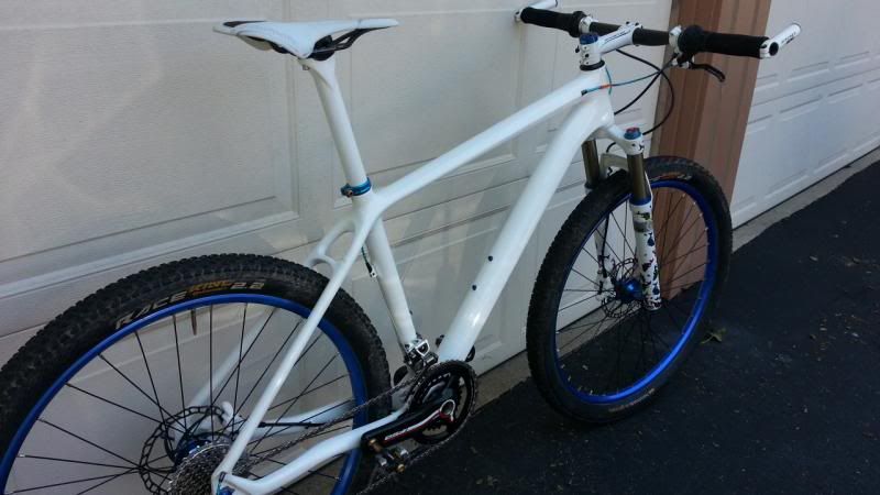

    Success! I lowered the fork, and it improved several things at the same time!
    I used the search function on mtbr, and saw how easy it was to work on the fork travel first, lol. I got the added side benefit of making the geometry a little quicker handling, lowering the bb height a little, and the fork feels a little stiffer. I also think the bike looks more badass with less fork leg showing.

    Did you ever consider one of the Syntace stems while keeping the fork at 100mm?
    Syntace
    I have no affiliation with them just something that I've read some guys using on here who wanted less rise. There are also some negative 15 and more stems out there FYI.

    Yes, I considered one of these stems, thanks for the link!
    First, I don't need a 100mm fork on a XC race bike, and I don't really like how it affects the geometry. It makes the head angle too slack, and 4" of travel makes the bike feel really unstable if it actually compresses that far, without a matching amount of rear suspension.
    The other thing I don't like about the neg rise stem, is that it puts the stem that much closer to my face, lol.
    I think I have the setup all sorted to my liking, and the bike felt great during my race yesterday.
    BTW, I pulled out the bb30 conversion bottom bracket, and used loctite bearing mount on all the fitted surfaces, and replaced those crappy wave washers, with bushing spacers I made to fit. Spins great, and is perfectly quiet now.

    How is the engagement of that rear hub? I've never seen hat brand but it appears nicely machined.
    Certified Clyde
    Reputation: Lurch98's Avatar
    90
    Quote Originally Posted by _Alberto_ View Post
    I'm curious also. I bought a bunch of MOWA stuff off the 'bay for my recent build, and it seemed great quality. I couldn't get myself to pull the trigger on the hubs.
    So far the MOWA hubs get a thumbs up! For the price they can't be beat.
    They have a nice loud click, but I haven't counted the clicks yet. Spin great, very light, and built up easily. I took them apart to check for wear, and so far after two races, and some training miles, still look great internally.
    Keep in mind that these are only XC use specific. I wouldn't use them for allmountain/dirt jumping/downhilling.
    They are similar in construction to the ROTAZ hubs I had before.

    The rims are sweet. They were designed to be a tubeless rim, and fit tight to the tire. They are virtual "carbon" copies of Easton rims. Built up easily, and even when a few rear spokes came loose after my initial break-in, they stayed straight and true. They are noticeably stiffer than the super thin Stan's aluminum rims.
    I built them 32 hole, 3x, and they still came in lighter than the 1300 gram wheelset I had previously, but I don't have a confirmed weight for them. The rims were around 280 grams each.
