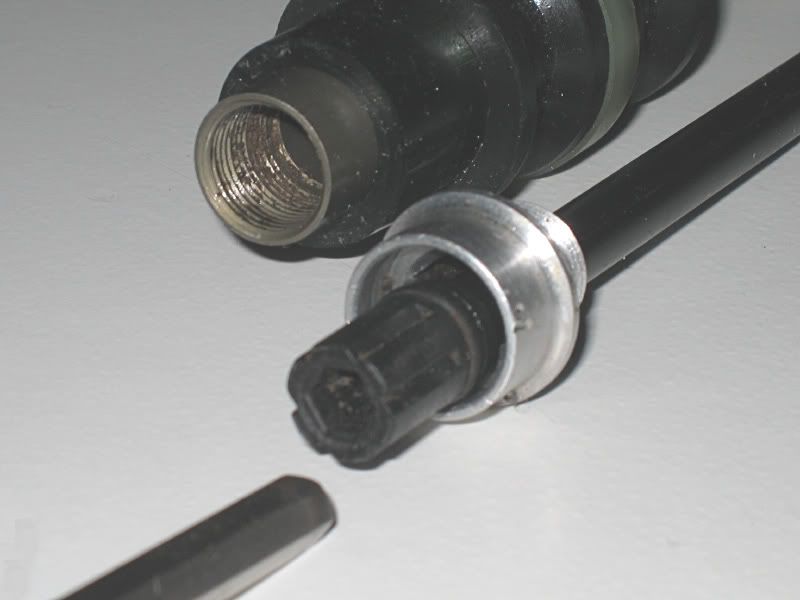

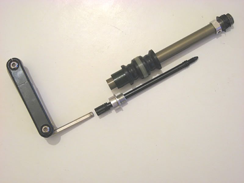

    The problem could also be that the Rebound adjuster (black plastic needle-shaped threaded rod with a 4mm or 5mm allen socket - have a closer look at the base of the fork leg through the hole of the big allen bolt) has been unscrewed beyond its thread engagement point so that it no longer forms a proper seal.
    If this is the problem, then just insert an allen key into the Rebound adjuster and turn it clockwise gently to fully close the rebound "valve" and engage more of the threads on the rod. The fork is then set to the default max rebound (fast) action - just remember not to unscrew the rebound adjuster too much when making adjustments when you set the fork up according to your weight.

    It seems the bike did not come with the rebound adjuster (the black plastic needle...) Any suggestions?

    Below is a spare Rebound rod that I dug out of my spares box, dissembled to show the black plastic needle and the Allen key tool used to remove it:
    Hope this helps.
    Edit: It is very common to find the plastic rebound knob missing as it was very prone to falling off on the trail if the little o-ring on it was worn or was shrunk by low temperatures. If this is the case, then just use the allen key to make the rebound adjustments.
