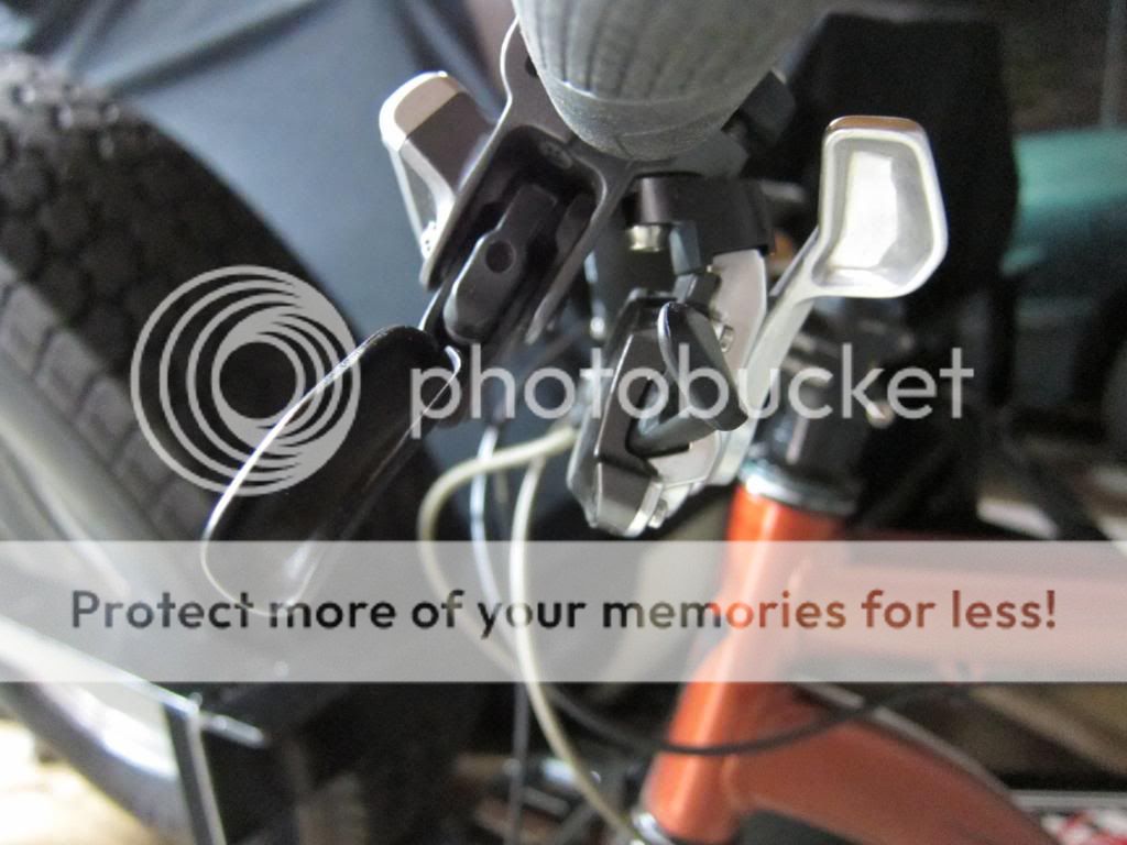

    Here are some pics of my 2012 slx brakes with my x9 shifters using problem solvers mismatch adapters
    The seem to offer about the same range of adjustment as i-spec brackets do

    This looks awesome, I am ordering some now. Thanks MrPretty for updating this thread

    These work great but a little spendy and you have to buy the right and left. But, they do solve my problem of having to jack with the shifter and make it not hit the grip. Great product!!! I have 2012 XT and 2012 X9 shifter.

    How is the shifter position relative to lever position. I would think it is most comfortable with the lever blade and shifter positioned parallel to one another. In the pictures, it looks like the levers are pointed downwards.
    Reputation: MrPretty's Avatar
    Feb 2012
    83
    I have a long upper body, so I'm not very stretched out on the bike, which is why the levers are pointed down, as are the brakes.
    The shifters are close to parallel with the brake levers, this is just a hair off from how I had them setup when they were on separate clamps.
    I am happy with the setup, it positions the shifters where I would expect them to be.
    On a side note, the shifters are adjusted as far as they can go outwards. I usually wear a large sized glove, and I feel if my hands were too much smaller, it might place the shifters a bit too far for me to reach (I felt the same about the i-Spec adapters). Although if you usually run your shifters inboard of the brakes I don't think this would be an issue.
