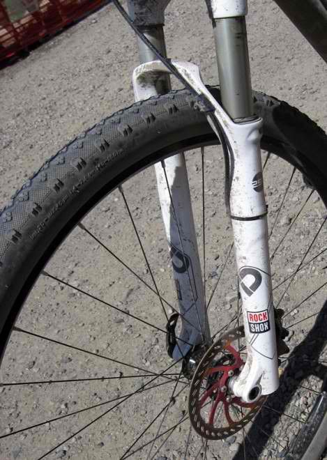

    On my road bikes, I agree. On the mtb, I agree with jlmuncie!!! Here is an example on Lance Pharmstrong's bike at last year's Leadville 100
    That doesn't look like a skewer; it looks like a 15mm Maxle, which is threaded on the left and thus has to have the lever on the right.
    Edit: And unless you're made of money and don't care about the longevity (and efficiency) of your purchases, don't oil your chain when it gets squeaky, keep it clean and lube it before it gets squeaky.
