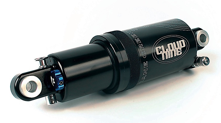

    I have an ancient Santa Cruz superlight (2001). I have fun on this bike and I have a 2 races left this year to do on it. These are just "for the experience" beginner races. BUT my rear shock no longer holds air as of 2 days ago. I am getting a new bike in a few months and I have already put too much money into this bike. I need a quick hack or ideas on the cheapest way to get this shock functioning for a short time. At the least I can get new seals and gaskets and fix it myself (which might go horribly wrong but I'm willing to try!) or I can buy a new used compatible shock. What would you do?

    Like this?
    Reputation: Vespasianus's Avatar
    5,277
    Like this?
    I think that might be it. I don't think CC had any other shock in 2001. I also thought that shock was rebuildable at home?

    It is an AD 12. I don't know if it matters but it isn't black. Are all CC AD's compatible regardless of the year?. I've seen some used on ebay-some pulled from different makes and years.

    Eye to eye and stroke length need to match. These measurements have always varied from one bike to another so you cannot just buy some random shock and expect it to fit.

    I disagree about not fixing the shock. https://www.amazon.com/Cane-Creek-AD...70_&dpSrc=srch

    If you do buy used I think you're looking for 200x57mm. A 200x51 would get you to the end of the season if you were in a jam, especially if the bike is near being retired anyway.

    I have seen this repair kit before and thought about it until I saw the complicated instructions that come with it. But, at $32 there isn't much to lose. I may have to give it a shot since looking for the right sized (used and cheap) replacement is becoming a headache too. I have 2 weeks to get it done, so it should work out.

    Assuming that all it needs are new seals and lubrication, this is an easy job to do. At this point, you won't know 100% until you do the job. But based on the direction of the discussion, I'm going to assume you've never had this done? It might be just the seals, but other parts of the shock may be excessively worn/damaged, too. Prepare yourself for that possibility.

    I kind of think that the OP could put a couple CCs of light weight fork oil in the air can through the Schrader valve and pump it up to see where it leaks out. It might be enough to get a notion of if it can be fixed or not. It could be as simple as a needing a new core in the valve.
